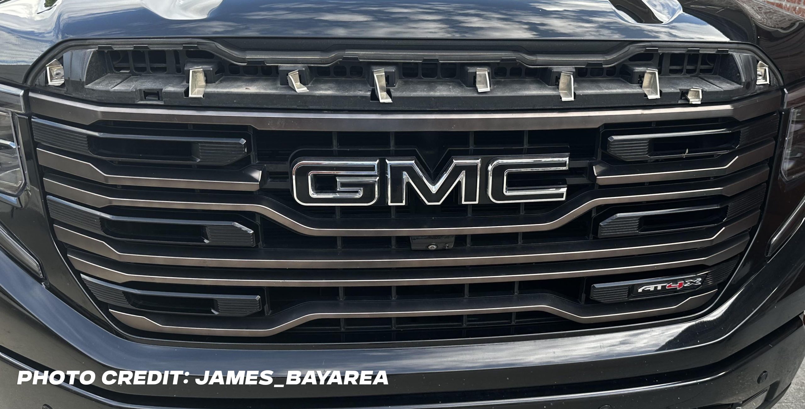

According to the National Highway Traffic Safety Administration (NHTSA) recall report, the issue stems from faulty attachment points on the front upper grille deflector. This piece, which sits at the top of the grille and connects to the hood, is prone to breaking over time. If all eight attachment points fail, the entire trim piece can fly off while driving—posing a potential road hazard.
GMC has acknowledged 1,225 field reports related to this defect, with four alleged accidents connected to the issue. However, as of now, no injuries have been reported.

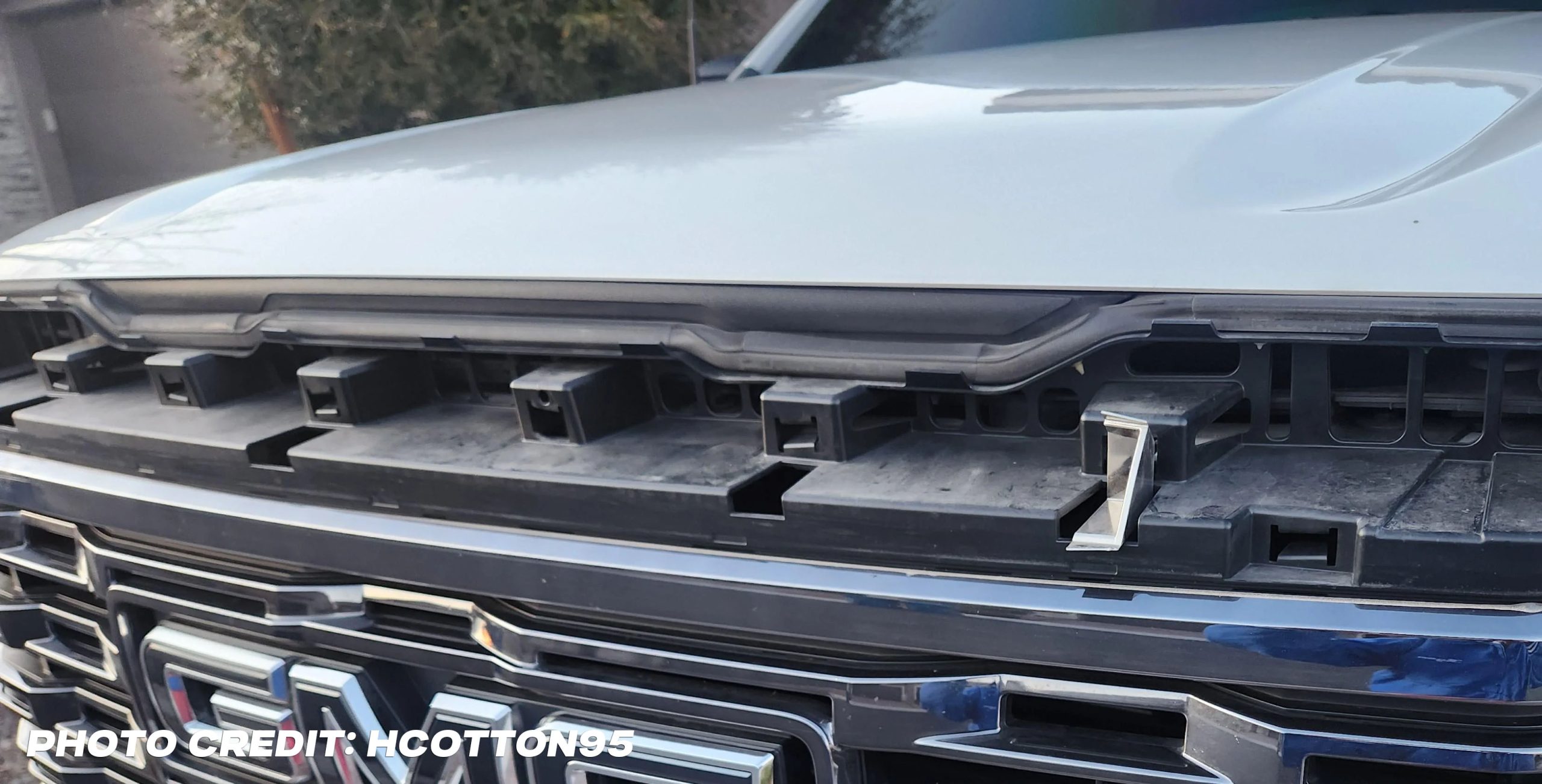

u/Hcotton95, who owns a Denali Ultimate, shared:
“I wasn’t quite sure what happened?? Originally thought someone really stole it in a shopping center parking lot in broad daylight? Otherwise, my truck is parked in my garage. Finally remembered I heard two ‘pops’ the day before but thought they were rocks hitting my windshield. Very upset but glad to know I’m not crazy!”
