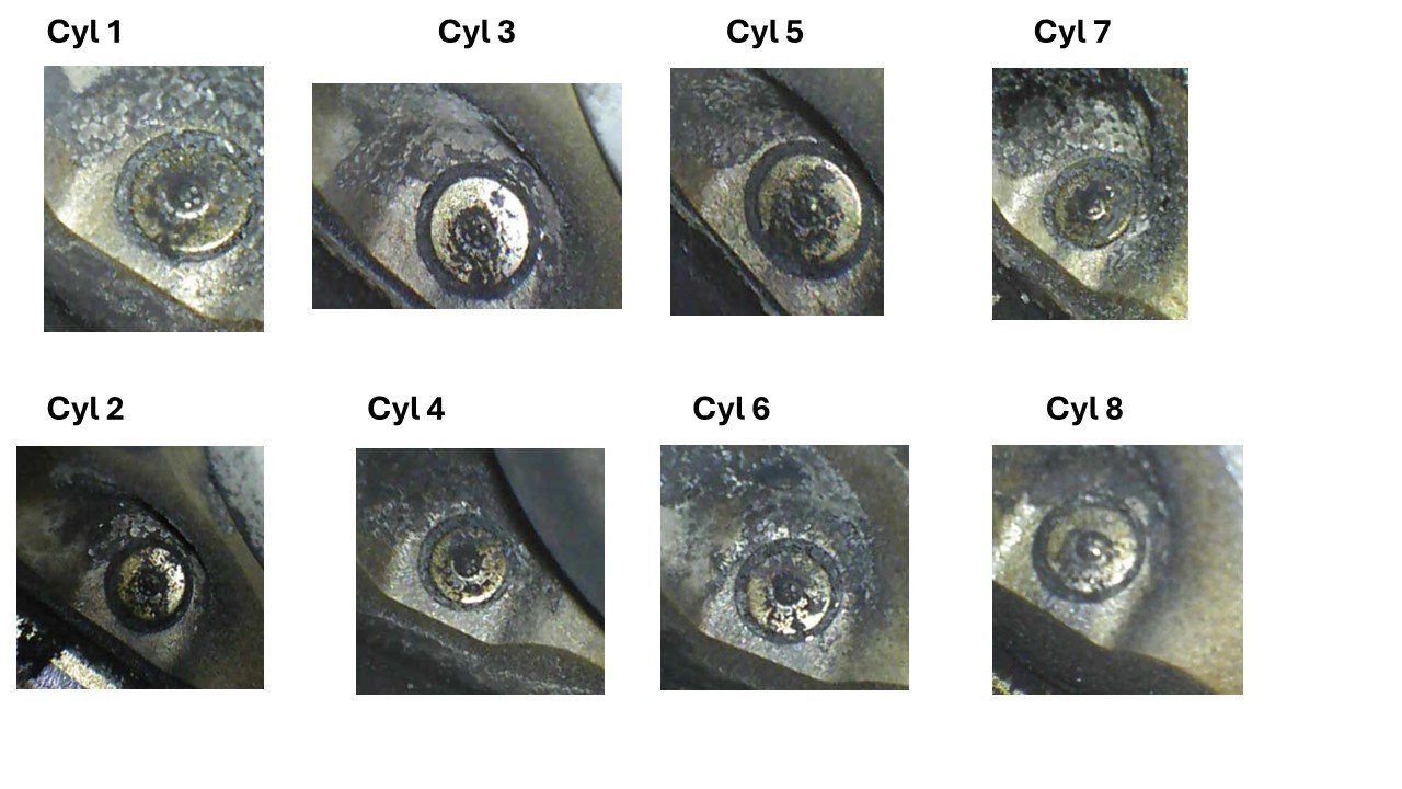

So far, I have checked compression in all cylinders and the they range from 200 to 210 psi. I boroscoped the pistons to see what I could see of the injectors and I could not conclude anything, maybe someone with more expertise can. Pictures attached. I have been tracking mileage and engine hours as well as dipstick level and it seems the first 500 miles / 20ish engine hours, the oil is pretty stable. Sometime within the next 500 miles / 20ish engine hours, the level starts to rise significantly to 3/8" to 1/2" above the full mark.

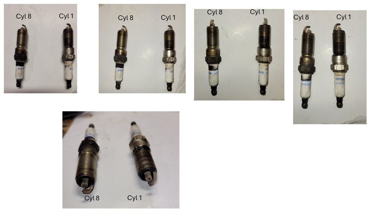

Final note is the spark plug from cylinder #8 has some carbon on the insulator which is different compared to the other cylinders. Some pictures attached of the plug from cyl #8 and cyl #1 for reference. Spark plugs have about 98k miles on them.
