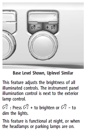

I did try the dimming switch, i didn't notice any difference.
I find that the response to the dimmer button starts slowly and then speeds up as the button is held longer.
Did you turn your lights into manual mode instead of automatic? I know that playing with the light switch will stop things like your entry and exit lighting on the exterior. Try to reboot your radio by holding the end call button on your wheel for 10-15 seconds.
