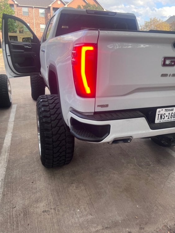

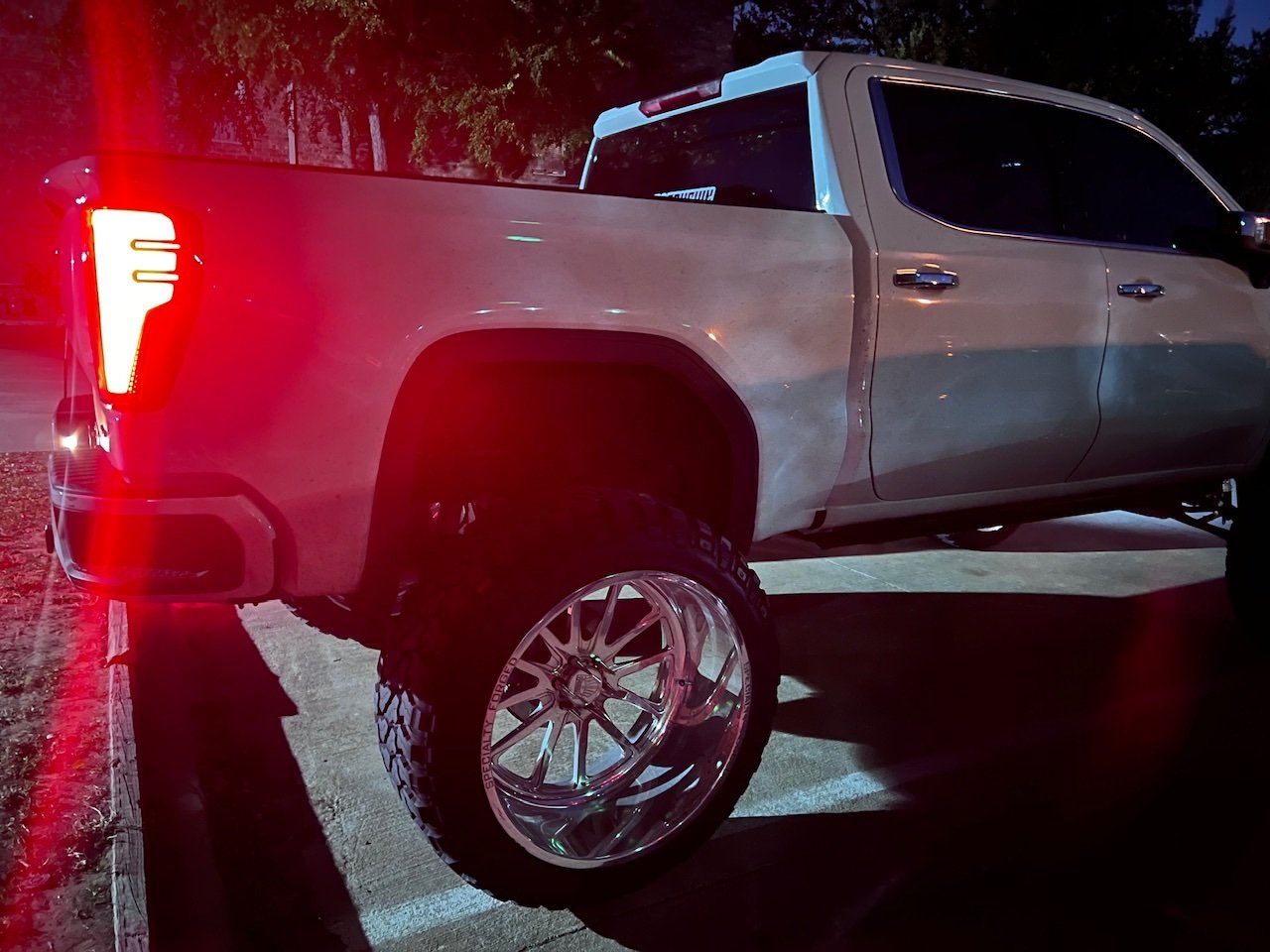

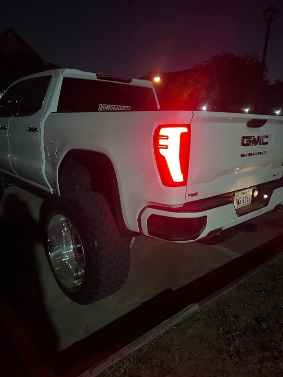

Finally got them installed yes they fit without modification, so have a minor issue when turn signals are on and pressing the brake they start to hyperflash, when I release the brake ped they flash normal. Dude is gonna check his wiring and check my wires via the vin from my truck and let me know something here tomorrow hopefully IMG_2568.thumb.jpeg.61ab4bd1c0cfa69c18a5648cd6c9ef3f.jpeg
