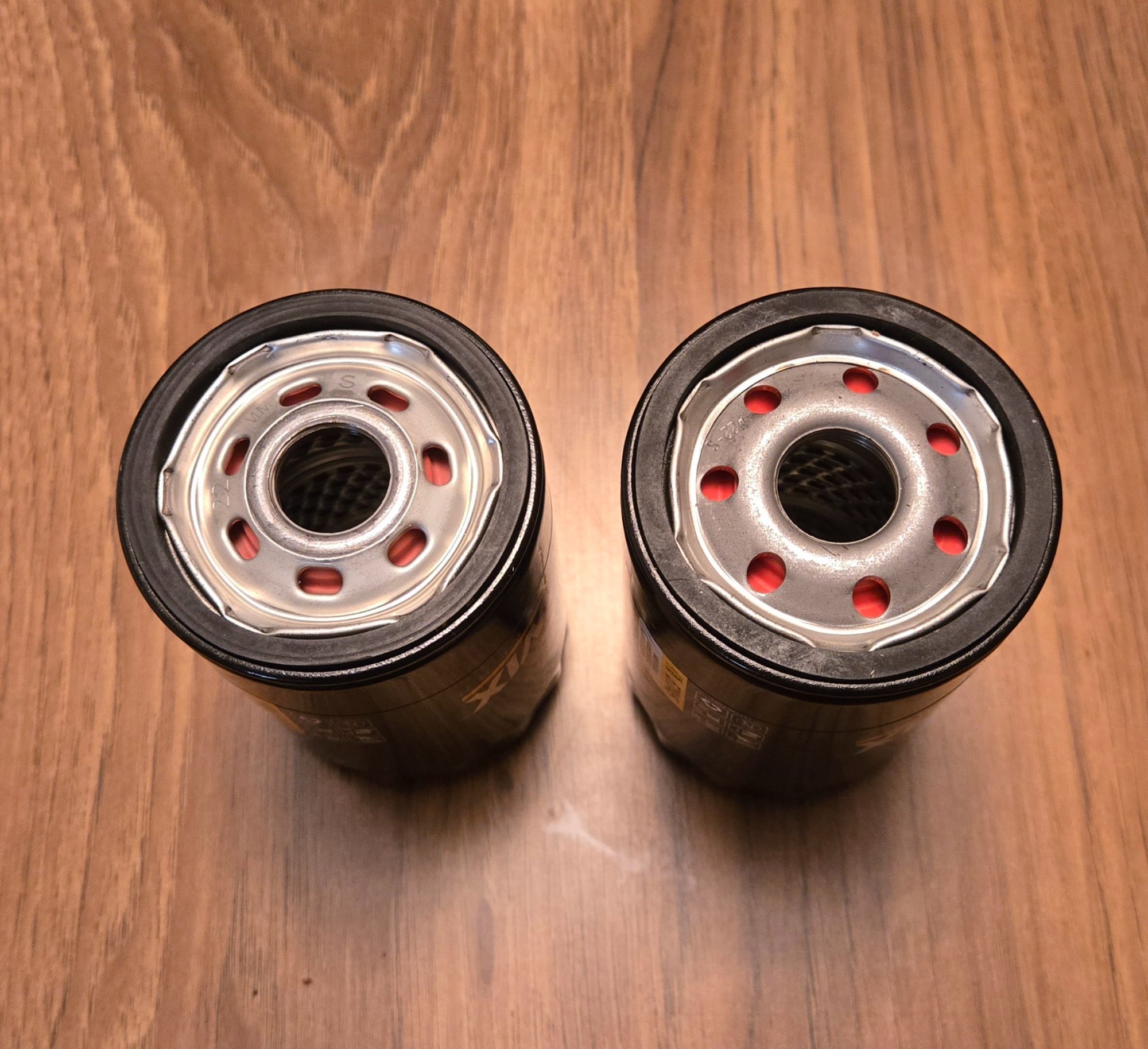

5 hours ago, C/K Man said:
Looks like all the 10522 oil filters in the Wix on-line catalog have the 'WL' prefix.  The 57060 does not.
When my nephew asked me last year to get him a WL10255 filter, I asked him. "Are you sure?" 'Yep' The number seemed completely foreign to what I had seen from WIX.
WL10255 on the left, 57045 on the right. 20241018_190504.thumb.jpg.47eb7c887505dd001e5ddc9d989e2e79.jpg
The WL10255 has the same number of holes, but a different shape. It will interesting to see if WIX revises the hole count to match the newest PF63. Also the WL10255 is slightly shorter. I don't have a PF63 to compare to.
On a side note, w/ the new truck, I now have 3 57045 filters that nobody in the family has a use for...
