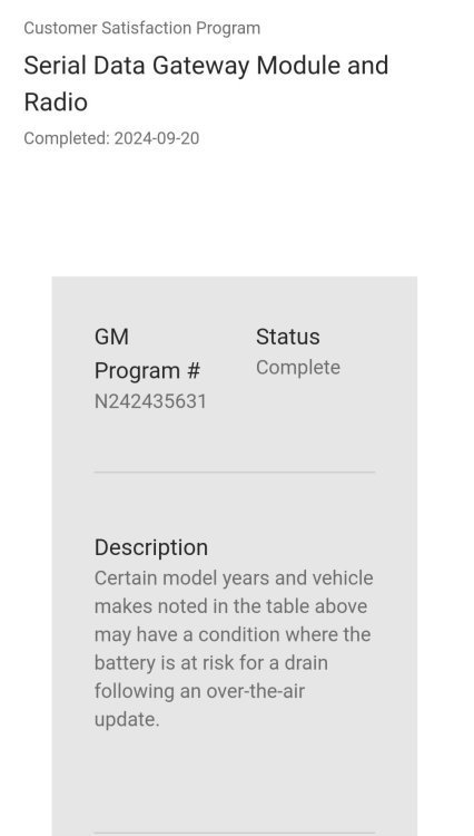

2 hours ago, 64BAwagon said:
If you look on your On star page for your truck it will show if its open even if you dont pay for a plan (I dont)
Follow the link if you get monthly e-mail reminders.
I thought of that after reading your previous message:
The completion date was the day before I picked it up. The other 'programs' (aux' battery wont charge for example) & recalls (tailgate may open) were completed by the dealer who initially had the truck.
EDIT: I had looked @ the 'Incomplete' tab, but hadn't thought to check 'Completed'.

On 10/21/2024 at 5:48 AM, 64BAwagon said:
Its technically not a recall, GM calls it a customer satisfaction program N242435631. My understanding is that its a new program designed to improve communication between modules and correct a possible situation where the battery may be discharging during a failed update. ( I believe is similar to what happened on some of the Colorados) There wasnt any information about the number or build dates of the effected trucks. I believe this was a mid year change once the new program was written so not all 24's will need it.
Thanks 64BAwagon !
Edited by BCGM
Today I got the email about the software update. I was planning on stopping @ the dealer on an unrelated matter, so will ask about this in relation to the 'completed' issue on the OnStar report.
Yes, the update had been completed before the sale. Service writer said that they had seen that in the past. Customer gets an email notification after the recall or campaign work had been done.
