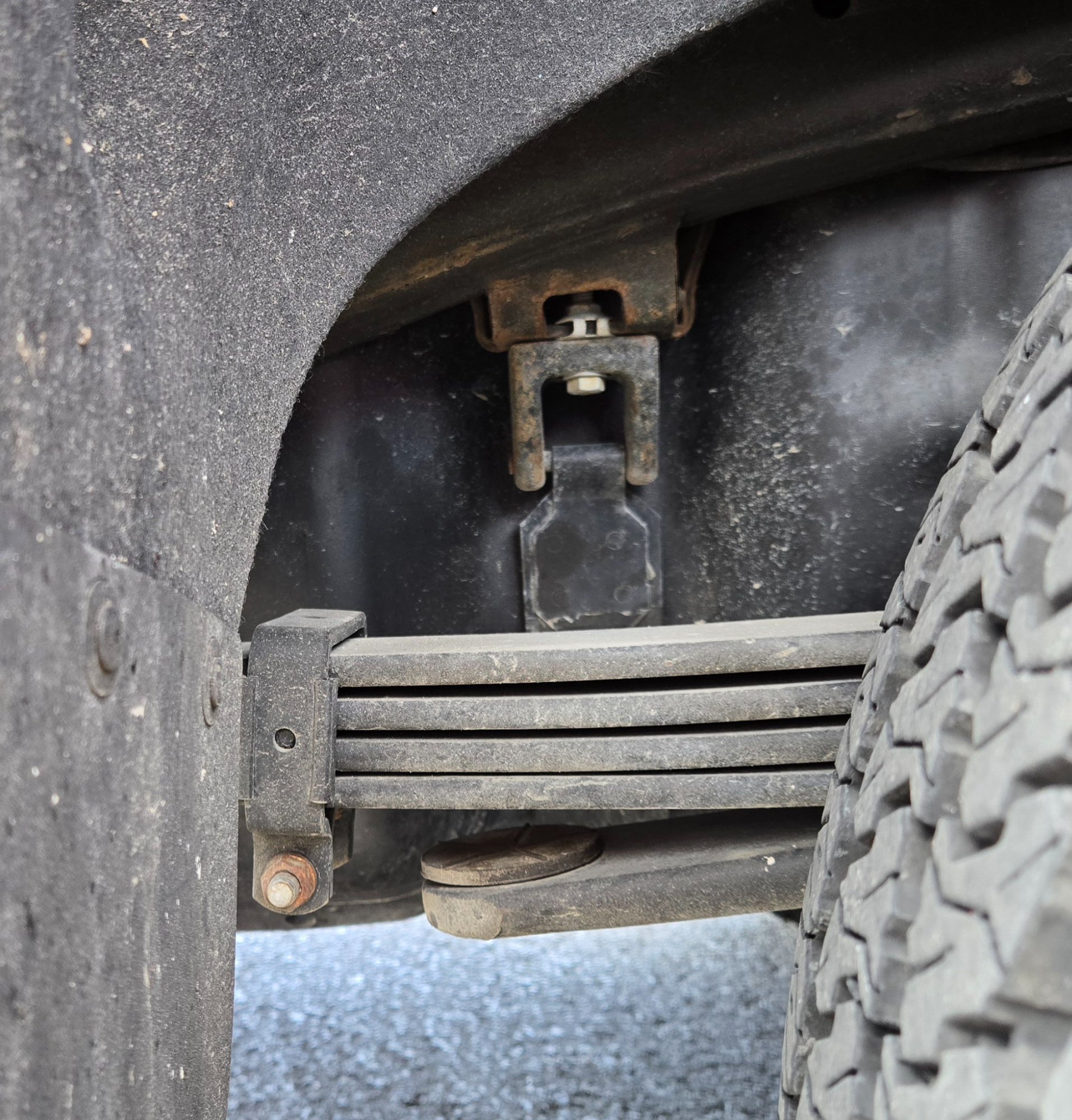

Are the T1XX HDs set up suspension wise so they ride softer empty but 'helper' springs take over when you start adding weight? I haven't looked @ the spring pack on my new truck to see how it is configured.
The 2500 spring pack has four primary stage leaf springs and a fifth second stage spring on the bottom of the pack that has fairly large end gaps to the primary springs. It begin to help when the suspension is depressed a couple of inches from the empty position.
The 3500 also has four primary stage springs and a similar fifth second stage leaf, but the end gaps are much smaller in the empty position and it begins helping much sooner. The 3500 also has a separate third stage spring above the axle that engages bumpers on the frame and adds support at around 2/3 payload  C36607AD-F5CF-4A96-8D64-413EFBC8F7D2.thumb.jpeg.cd067df6c35070e1c6af1dc8620575ee.jpeg

Thanks for the explanation. I'll post a similar pic from mine.
