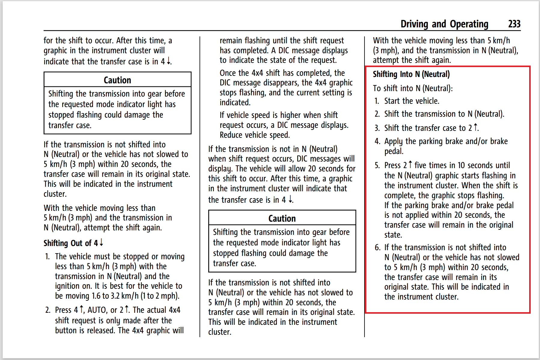

@newdude will the two speed transfer case shift to neutral with the engine off?
Transmission has to be in neutral to shift the transfer case into neutral first, so engine has to be running on a console shift truck.  It doesn't specify for column shift but I assume they wrote it this way to cover both.
