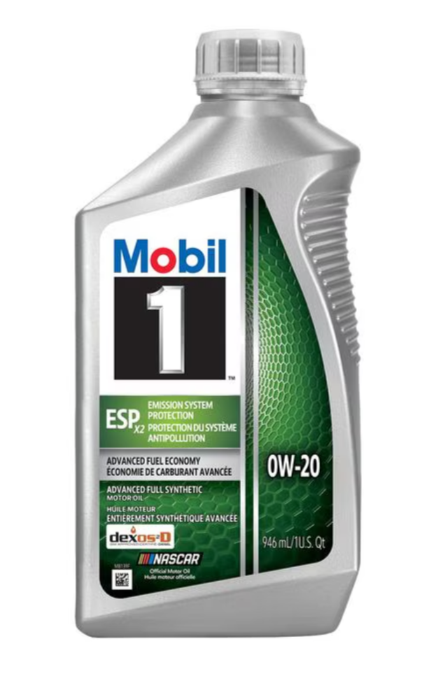

Agree on the programing. The other issue is finding spec oil. I had to go to the dealer for oil. No one else around here had it in stock.
Where do you live? I have bought Mobil 1 Dexos D oil at the Auto Zones where I live and at times the local Walmart has had it.
