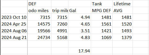

Haven't been able to make that happen (yet) with this LZO --  but I have got it close, and I fill at a commercial, metered, bulk location so I can get a better handle on how much DEF it is using.
Truck is running better than 29 mpg lifetime, and I've added def about every 7000 miles.
Lifetime fuel was running 29.6 when the last def fill was done
29.6 / 1379 x 100% = 2.1%
Last fill, only the last partial segment was still 'on'.
