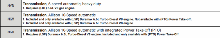

2023 2500 factory offerings.  (retail and fleet versions)
Of course you can change diff ratios, but 4.10 wasn't offered in 2023
I don't know for sure, but 20 - 22 likely they same.  4:10 may have been last offered with the 6.0 -- 2019 and earlier
2023
2019
Dmax and 6.0 both had speed transmissions.

3.73 because that is all they offer now with the 6.6. gas 2020-curent.  Transmission changed from the 6L90 to the 10L1000 for 2024, and the 10 speed/3.73 combo is great.
Can't get 4.10s anymore though from factory.  Diesel is 3.42 only.
