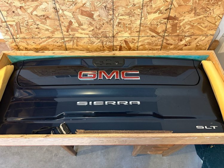

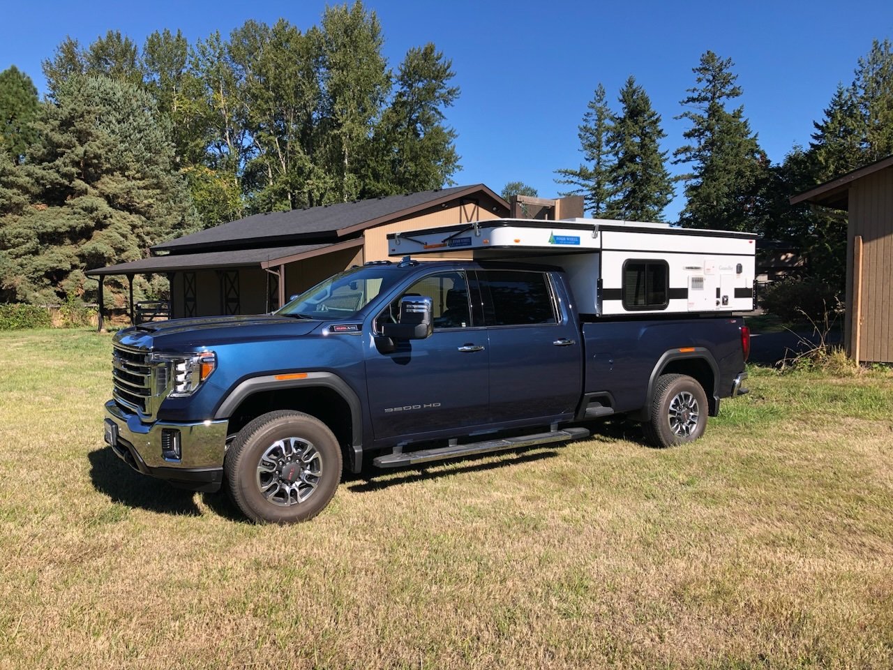

Sounds like a great use of the truck.  I went through the process a couple years ago and ended up with a GMC 2022 3500, 8' bed, SRW and double cab.  Also chose not to get the fancy tailgate.
My camper extends to the rear lights.  So I remove the tailgate when using the camper.  This requires a wrench to remove the bolts at the end of the tailgate cable fastened to the truck bed.  I will on occasion use a makeshift support beneath the opened tailgate but just holding it up by leaning into it is not a problem.
Prior to removing the 2 bolts I disconnect the snap connection to the camera located underneath near a cluster of other cables.  I also remove a multi-pin connector that has a lever clamp with slide lock and located a little further front from the camera connector.  At this time I reinsert a dummy connector and lock it in place (aftermarket part).
Then I remove the tailgate trying to carefully pull the 2 cables with their end connectors through the hole in the sheet metal.  At this time I route the cable from a different camera (aftermarket) through that hole and connect to the connector used by the tailgate camera.  For now I just have a simple wooden extension from the hole to the aftermarket camera and have found it to be sufficient; no need to mount on the camper.
When ordering the camper I believed the double cab longbed would be too long so was focused on crew.  But to get most of the options I required I had to get the double.  Well, I believe I am happy to say it was a good choice.  The back seat is a giant junk drawer.  Many long messy objects and fly fishing equipment go there so I need not mess-up the camper.
I wanted SRW because fishing often requires traveling on gravel/rock rough roads.  Check the discussion groups and you will find many people talk about the problems of trapped rocks and mud between the wheels.  I also made sure to get the 18" sized wheels that allow the use of chains or so I hope as I may have to use them for a possible late year trip in the snow.

Multi flex tailgate weighs 75 lbs.  The powered one would be similar - maybe a little lighter.  I remove and install mine a couple times per year. It’s a two person job, not so much because of weight, but  rather because it is too big to get your arms around. I can remove my 93 truck tailgate easily myself.

I have a 2021 GMC 3500hd CCLB SRW Gas in SLT trim with pretty much all the interior options and dual batteries (single 220 amp alternator), so probably about as heavy as a gas SLT comes. My scale weights with 220 lb driver and full fuel tank are 4440 lbs on the front axle and 3280 lbs on the rear axle. I assume the front axle weight of a 2024 DRW gas SLT would be pretty much the same, but note that the 10 speed transmission is a little heavier. So you would have 5200-4440=760 lbs of front axle capacity available for load in addition to the 220 lbs driver weight in my numbers. Add three more adults takes up 300 to 400 lbs of that. Not much left for front axle camper load, but as you said many campers don’t put much static load on the front axle.
Based on this I think if you are installing a 4500 lbs wet slide-in, you should probably get the F60 springs to bump the front axle rating up 400 lbs to 5600 for some margin, especially if you are going to hang 200 lbs of bikes and rack on the front. It may be the best spring choice for your load, and your data plate will show you legal even with quite a bit of camper weight on the front axle. It will increase lateral stiffness as well. You can always put 5200 lb springs in if you don’t like it (as I did) for not much money and effort.   I think the plow package with 6000 lb springs is probably unnecessary for you and you would not like the ride difference.  Maybe others will have a different opinion, though.
The payload rating of my truck is 4054 lbs. The camper rating is about 3200 I think. You definitely are making the right choice with a DRW to carry a 4500 lbs wet camper and be able tow a 5000 lbs boat trailer with 500 lbs on the hitch (maybe even an extended hitch?). You won’t be overloaded, and your lateral stiffness and stability in wind with a tall camper will be much better.  We all know the downsides of a dually, but if you need one you need one.
It looks like I'd wind up the the powered tailgate since it is tied to some options I want.  Once that happens it doesn't seem like the Multi-Flex tailgate would add much more weight over the powered tailgate so I might as well add it if I think I'd use it, does that sound correct?

I would not decide between the tailgates based on weight. They are very close in weight. Instead, I would choose based on which functionality I preferred.  Is the multiflex even offered as an option for your truck?  I’m not sure it’s just a swap - the wiring would have some differences.
I have the multiflex and pretty much never use it as anything other than a conventional tailgate except when showing it to somebody. However, I either have the tailgate off for a slide in camper or I’m running the bare truck. If I had a canopy or topper and was camping in that I would use it a lot. The bed is quite high, so the step function would be nice for that use.
If I had the option of a powered gate instead it would have been a hard decision. It’s almost a two hand lift for me to close the tailgate, so powered might be nice. At rhe time I bought my 3500 SLT it was conventional non-powered one-piece or multiflex, and the price was the same, so I bought multiflex.
I don’t really like the electric latched tailgate thing in any form - more stuff to potentially fail. I like the old school gate on my 93. I can pop it off myself in less than a minute.  My multiflex is a two man half hour job to remove or install including crating, and it lives closed in this crate 7 months out of the year.
