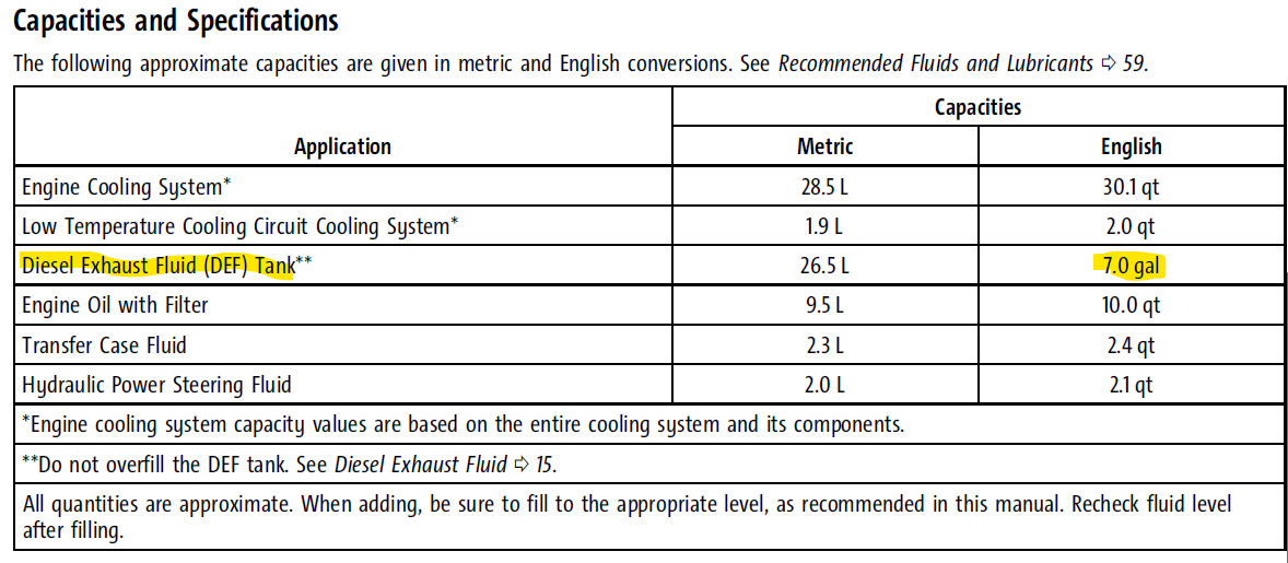

How much do these DEF tanks hold?

If it's using a whole tank -- 7 gallons -- for 93 gal fuel,
that would be 7.5% --
