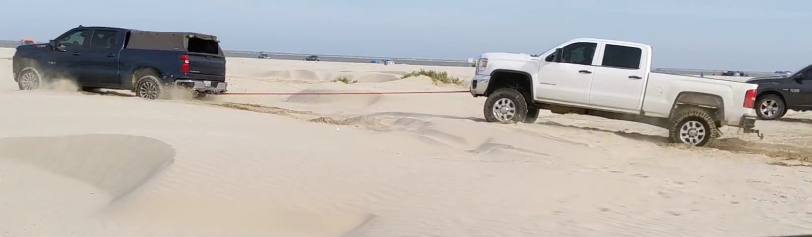

In sand, lowering your PSI will do more for traction than just about anything.  However, if you are in 4HI, make sure you turn off your traction control or it will cause you all sorts of issues in the sand.
I have had 33" Wrangler Ultra Terrain AT, 33" Bridgestone Dueler, and 32" Wrangler DuraTracs, and all have done exceptionally well in the sand.  For sand recovery, the Duratracs and UltraTerrains were best, but for normal beach driving the Duelers were perfectly fine.
I prefer to be in 4Hi and just drive.  With traction control turned off, and moving at a decent pace in 4HI, I have never gotten stuck, even with the Duelers at full PSI that are more highway than anything.
Basically, if you are going to be going through deep sand, then you need to air down, turn off traction control, and try to stay on top of the sand with a little bit extra speed.  When you come to a stop, roll to a stop.  DO NOT USE THE BRAKES IN DEEP/SOFT SAND.  If the sand isnt deep and soft, just put the truck in 4Hi with the traction control off and don't worry about PSI.
Compact Sand:
4HI, Traction Control off
Deep Soft Sand:
Lower PSI, 4Hi, Traction Control OFF, keep your speed up to stay on top.
The picture below is me recovering a 2500 that busted a CV on the beach.  4Hi, skinny pedal down, and letting it eat.
