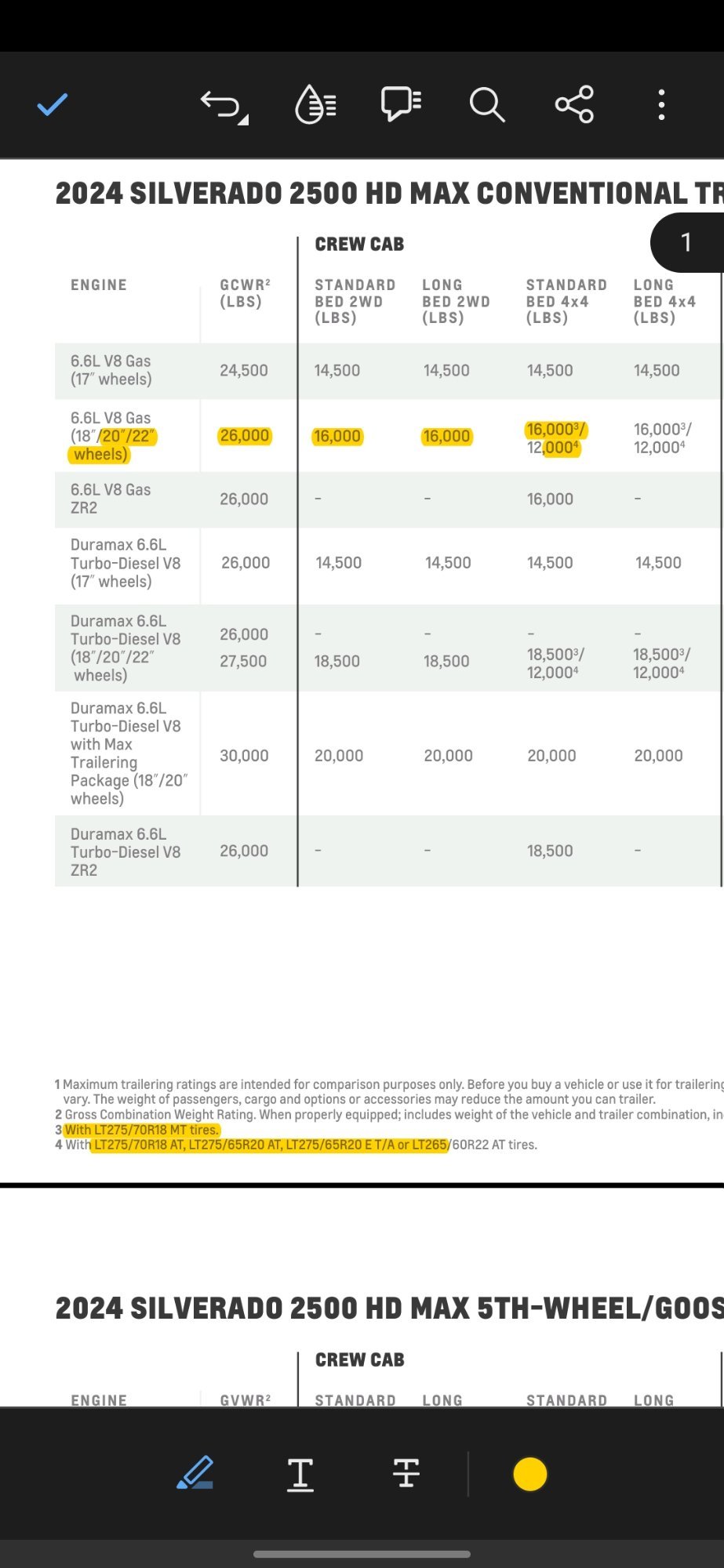

7 hours ago, bigblue2024 said:
Thank you everyone. This is the brochure or towing guide I was referring to. Thank you newdude. The ordering guide makes sense. The load index on my tires is 126, so I'm pretty sure I'm good there.Screenshot_20240803_090732_AdobeAcrobat.thumb.jpg.42e07da97dc5ed9f2650b83bdbc18756.jpg
Yea looks like they have that reversed.

There is a typo in the Chevrolet website footnote and I have been trying to fix it for a month or so.
Only trucks with QG3 - Hankook dynpro have the reduced conventional towing.  The gooseneck fifth wheel numbers are unchanged.  This tire is no longer available but you may still find a few on the lots.
#iworkforGM
#iworkforGM
QG3 does have a 'no longer available' note in the order guide
