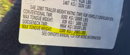

3 hours ago, Chfc2 said:
this tag
Seems pretty common sense to me, a gooseneck and fifth wheel both place the trailer tongue weight in the same location...

On 7/23/2024 at 7:32 PM, Chfc2 said:
IMG_5279.thumb.jpeg.53bed132d476e80cd7d86c005f439c22.jpegWhat pin weight on a 5th wheel can I legally have
Your goose/5th pin per the sticker is 2865lbs.
GM uses 15% of trailer weight to calculate tongue for the sticker.  So 19,100lbs max trailer 5th/goose, 15% of that is 2865lbs (19,100 multiply by 0.15).
So say you bought a 14,000lbs 5th wheel camper trailer, you'd want to keep your pin around 2100lbs, which is 15%.  I wouldn't go less, but if its a bit past that would be okay.  GM says to not exceed 25%.
Conventional trailer hitch they use 10% of trailer for tongue.
