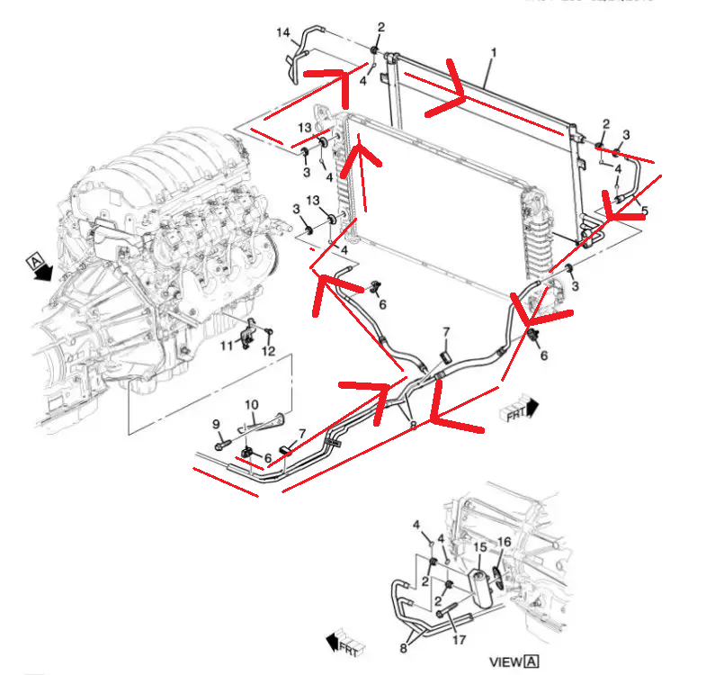

You do have the heavy cooling because its a V8.  Being its a 2015, your transmission cooler fluid path goes to the tranmission cooler tank in the main engine radiator first, then out to the auxiliary cooler which is a part of the AC condenser out front.
Here's the cooler line flow for your truck:
Even with the TBV bypass installed, you will still see higher temps than a later built truck like a 2017 or 2018 as those do not flow through the radiator.
The Mishimoto kit appears to add its cooler as a 3rd cooler inline with the factory setup.  So the out line from the condenser gets replaced with a line that will flow it to the Mishimoto, and then from the Mishimoto it will connect back to the transmission inlet line.  You will probably see a temp reduction if you install this because you have a 2014-early 2016 truck.
One thing I would consider though is experimenting with the lower temp TBV that GM has if the truck runs too cold empty.  Especially if you live where it gets cold, the Mishimoto might overcool, but again, you won't know until you set it up on your truck.
The early trucks that use the 'hot tank' for a cooler, aren't using it as a cooler but as a heater. 207 F+ water temp on entry.
If it were mine AND I the AC condenser is in play I'd bypass the radiator part of the system and run it like a 2017 +.
Am I wrong?

I don't know how I missed that it's going through the condenser all this time, but I honestly never knew that.  That's wild.  It makes sense.  I always knew the engine coolant would warm it up when it's cold, but I just assumed the engine coolant was the only "cooler" for the transmission.   There's always something to learn.
Am I wrong?
So originally I was considering bypassing the radiator with an aftermarket cooler.  But then I saw that kit with all the lines pre-bent and was intrigued.  That was also before I knew about the condenser being in play.
Your thought about the newer GM part is a good one too, but I'd have to change the lines to use it I think.  Unless the innards fit in the thermostat block I already have.  I suppose I could just make new line altogether too, but I don't really have the tools for that on hand. I'll consider that.
