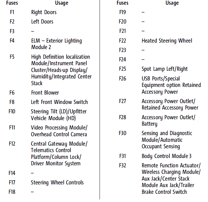

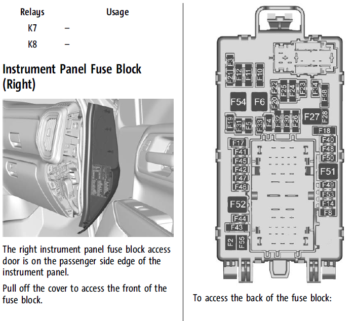

Have you tried moving the block that connects to F27 so it connects to F28 instead?
Front side of passenger side fuse block

I previously was on F28 and switched it to F27 since I don't need the camera recording 24x7 and have it drain my battery on the truck unnecessarily.
So far what might have done the trick is to use a USB data blocker in line with the USB that goes to the camera. Why in the world I have to use that all of a sudden is weird but it was a suggestion my boss gave me and it seems to be working. If by the end of this week the dash cam is still working then that was my fix because usually after 4 days of driving around the camera would freeze up and crash from a dead internal battery on it when I wasn't using the usb data blocker.
So update on the fuse in the instrument cluster at the passenger side. That circuit swap does nothing to the USB ports on the dashboard and only affects the USB's in the center console or at the back seat. IDK why GM had to make one set of USB's so they are always on retained accessory power only but you can control the other 2.
