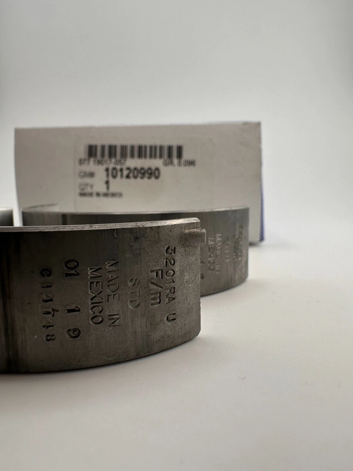

Going off pictures on eBay of the bearing p/n 10120990 (which is the current main bearing #), the ones with the "GM" look to be GM bearings.  The ones with the A921 and A926 are likely aftermarket bearings, so I'd say someone might have been in that engine before.
Here's a picture of one out of a fairly new box and its stampings:
NEW OEM GM GENUINE MAIN CRANKSHAFT BEARING 10120990 - Picture 2 of 2

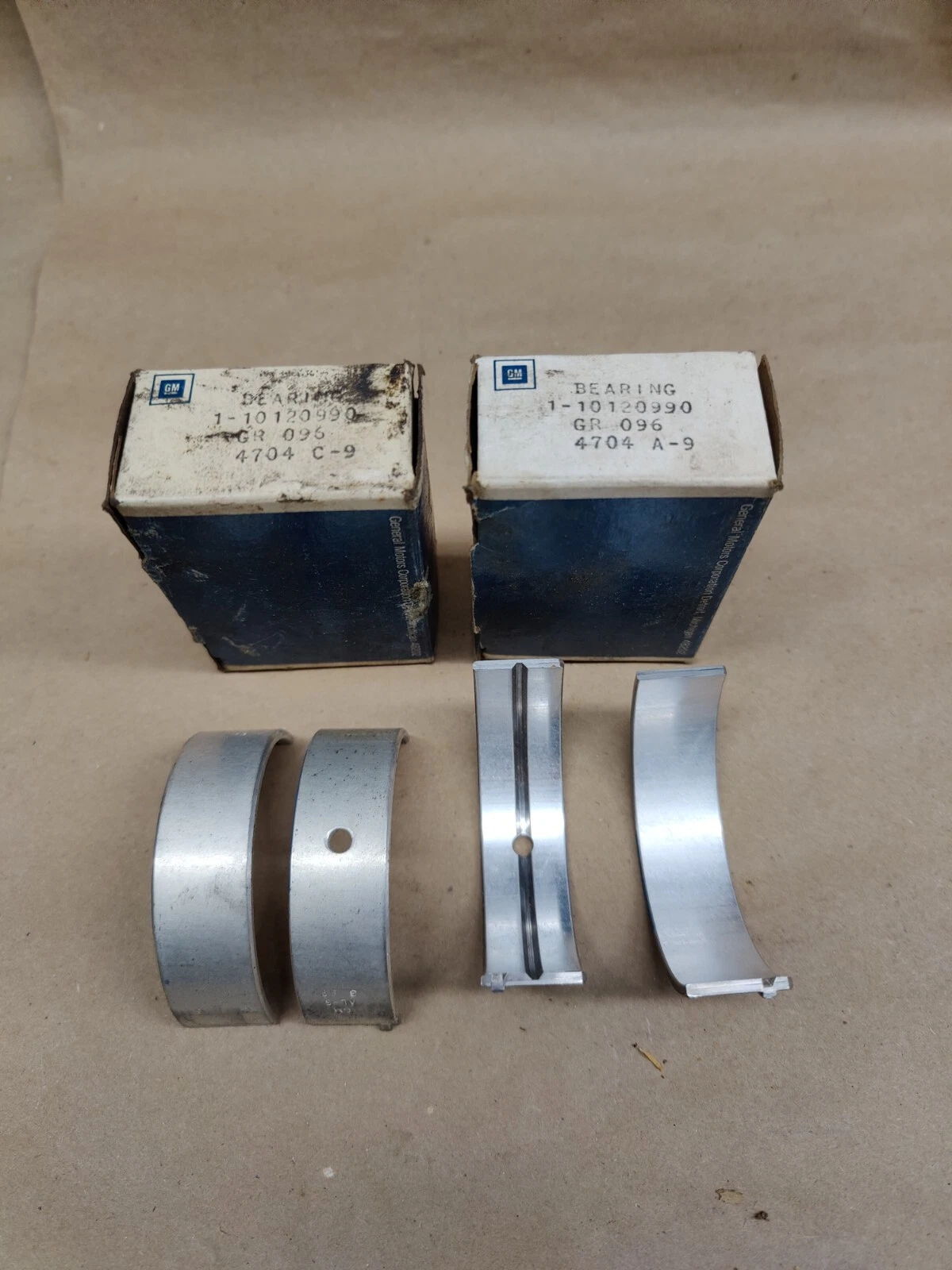

Here's the stampings from some older stock:
NOS OEM 1982-02 Chevy 5.0L V8 crankshaft main bearing GM #: 10120990 - Picture 1 of 2
If you look at the second bearing half from the left its stamped like your first picture.
Here's some evidence of the "GM A-100" on factory bearings in an older engine.  The bottom numbers are date code so your "GM A-100 8-01" is a factory GM standard bearing, August 2001.
