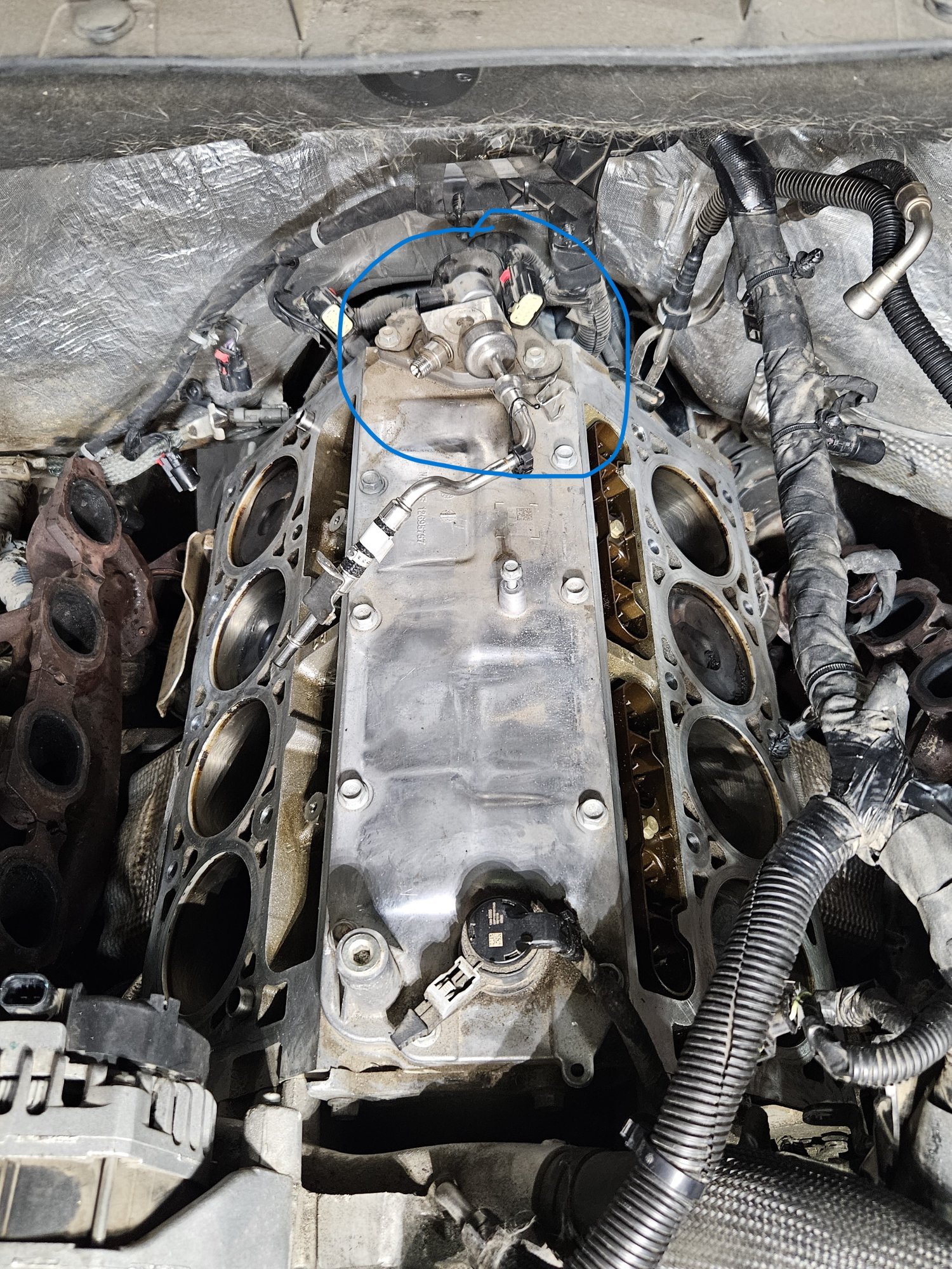

Gangly Posted June 18 Share Posted June 18 (edited) The HPFP(High Pressure Fuel Pump) is located beneath the intake manifold. You will have to remove the intake manifold to swap out the injectors, so you might as well do the HPFP at the same time since its right there and only 2 bolts. The HPFP is circled in the image below. Note: The heads DO NOT have to be removed to access the injectors and the high pressure fuel system, only the intake manifold. Edited June 18 by Gangly Quote Link to comment Share on other sites More sharing options...
Tdola Posted June 18 Author Share Posted June 18 (edited) 3 minutes ago, Gangly said: The HPFP(High Pressure Fuel Pump) is located beneath the intake manifold. You will have to remove the intake manifold to swap out the injectors, so you might as well do the HPFP at the same time. Ahhh I see. Well the Intake manifold is also coming off for the Magnuson Supercharger too so like you said, now’s the time to do it. Thanks for the advice. Edited June 18 by Tdola Quote Link to comment Share on other sites More sharing options...
