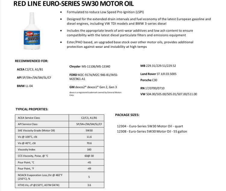

Here's the problem Stan. The oils you and I grew up with.....they are few and far between anymore.
What you and I and most our age grew up with:
More recently:
Motor Oil Basics: Oil Viscosity Grades Select Synthetics, 53% OFF
Dexos1Gen2 and 3 have a 0W20 HTHS of the minimum 2.6 cP Group III/IV
Red Line HP 0W20 is a 2.9 cP fluid. (SAE 30 spec) POA/POE
Evolve EvoSyn 0W20 is at 2.91, also SAE 30 84% plant based.
Every Choice Matters
You not believing that doesn't.
