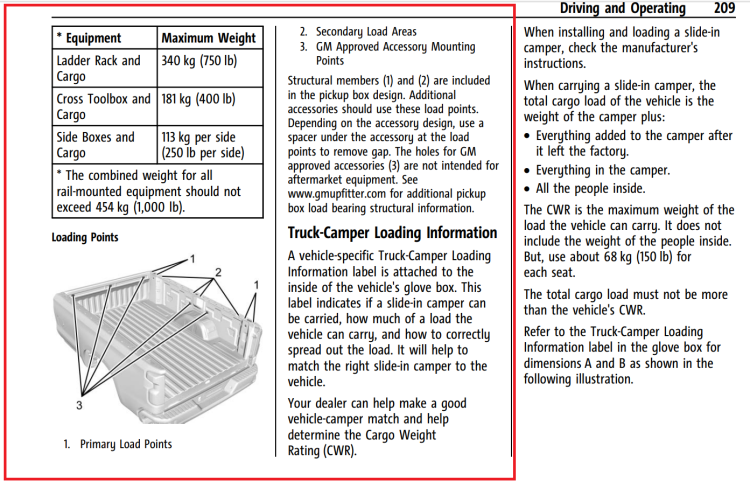

Any idea how much weight the sides of the box are rated to carry? Or where I can look to find a rating?  My searches are failing.  The dealer is clueless.
I want to add racks for carrying ladders, pipe, boards, kayaks, etc. Probably no more than 300 lbs. Racks I've read about list a weight capacity for the racks but in the fine print say not to go over the trucks capacity. Which makes sense, I just have to find the trucks capacity....

Thank you very much for this.  Don't know how I missed it but there it is right in the owners manual....I'm an idiot
They don't print the "full" manual like they used to so you might not have seen it in yours.  They now just print like a get to know your truck booklet.

I don't actually own the truck yet so I'm looking at the online manual, just failed to see it.  I saw the page # in your post so I checked and sure enough, there it is.
