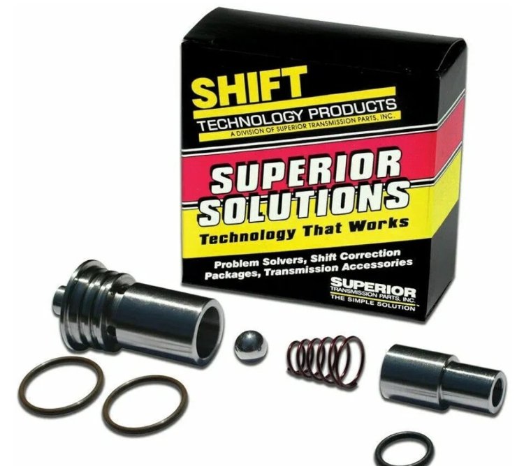

This is what I put in my 2018. I don't remember exact temperatures it runs at. I have not drove it since October.  I do remember pulling my model A around in September it was running 170°
Screenshot_20240520_001731_AmazonShopping.thumb.jpg.be4a300d216a14d22a50f5cada04009f.jpg
