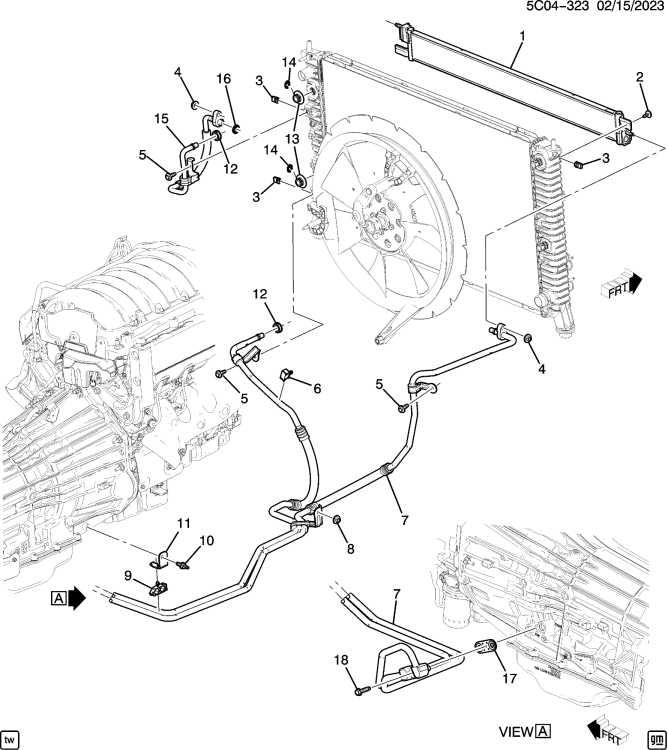

Here's the cooler lines for the 10L1000 with the 6.6 Gas.  Once the TBV is opened or starts to open (143F), ATF will flow from the transmission to the fitting at the bottom of the LH radiator tank (callout #13 with the line down).  ATF will then come out the top fitting (callout #13 line pointing up) and into the short pipe (callout #15) and then through the auxiliary cooler (callout #1).  From the aux, it will the flow back to the transmission.
So when up and running for a bit, and the TBV is wide open, the transmission should run within 10-20 degrees of engine coolant temperature because the ATF flows first through that left tank on the radiator.  The Aux cooler being mounted ahead of the radiator (and probably the condenser) allows that fluid to cool to that 10-20 degree window below water temp.
Always comes in with amazing content and pics for everything. Thanks!
NewDude Thank you so much for the graphic and explanation ! I will post my take on what you have provided in hopes that I have got it !
