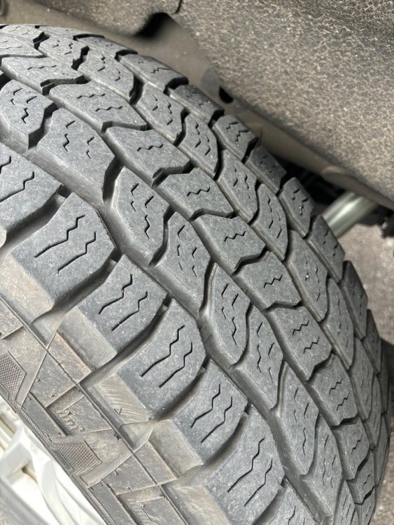

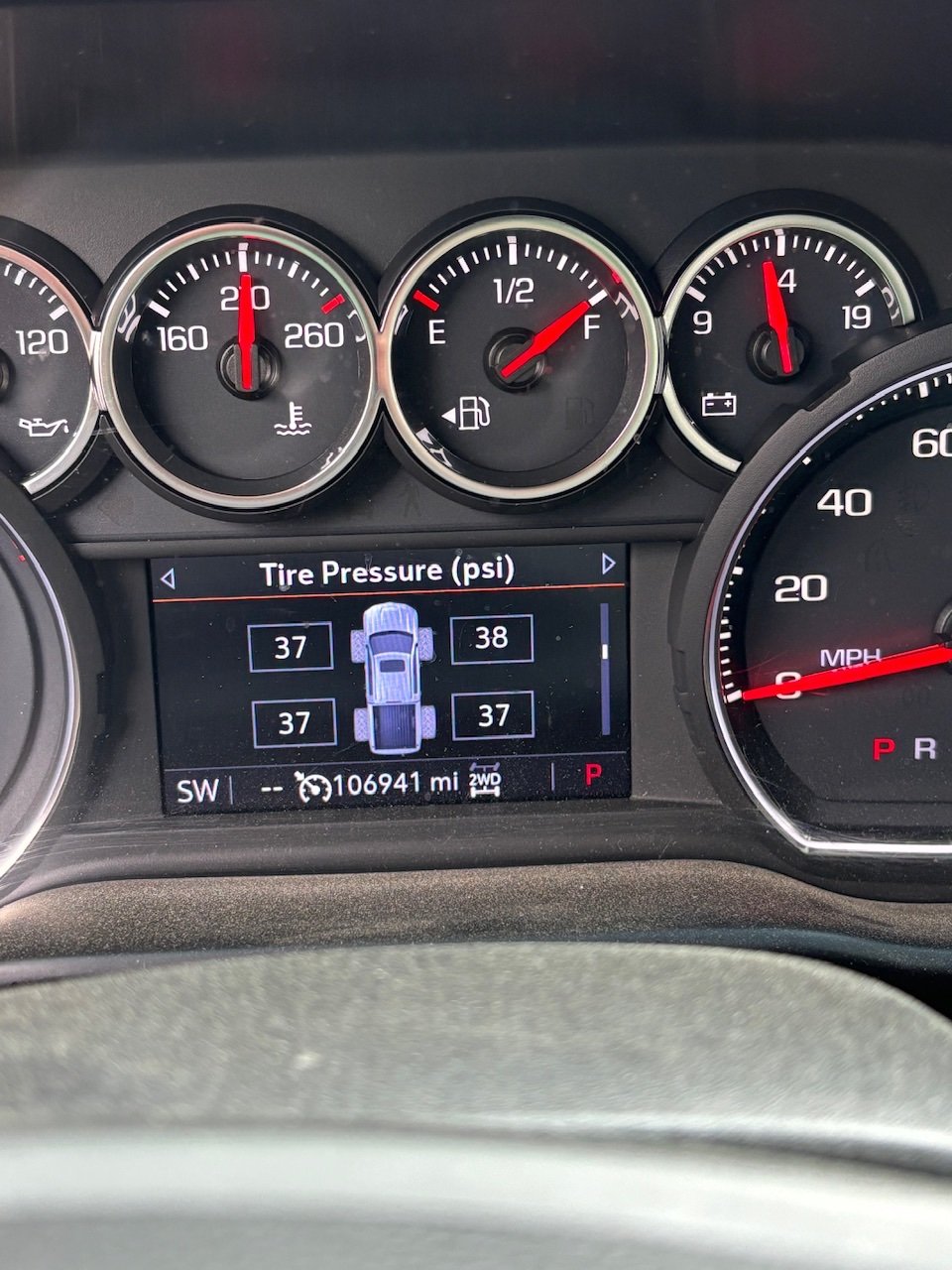

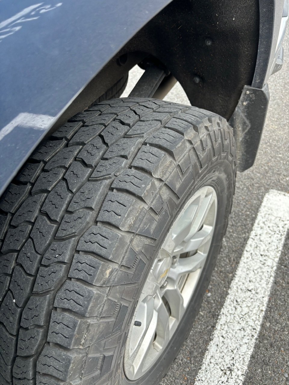

Current pressures on warm tires.
IMG_3797.thumb.jpeg.c66160af2c525c49f1c160ef0cb52038.jpegIMG_3798.thumb.jpeg.62c65d5b5f27ab15ed88ca17c20a201d.jpegIMG_3799.thumb.jpeg.9e67d353d97d2134d672f77ebc6eec9e.jpegIMG_3800.thumb.jpeg.fc68e57b88306d72cb437dec5b0845ac.jpeg
If you look closely you can see the tire is a bit over inflated and the full tread width isn’t hitting the ground.

I never asked you for "proof" for something that's not provable on the internet.  Your pictures are pointless, I have no way of knowing that those pics of tires that certainly don't look like 40k mile tires are even yours.  So you're doing the very thing you accuse me of - accusations and claims without proof.
Oh and I guess you failed to notice the scalloping on your inner tread?
IMG_3798.jpeg.325a45e960a49f92ed9a8d7e5100a6be.thumb.jpeg.5bf01aa4fa671d3b633ce88d8c684f77.jpeg
That entire tread is indeed making contact, and the inside in particular is getting hammered.  You need more pressure and probably new shocks...but again, that's assuming those are even your tires.
