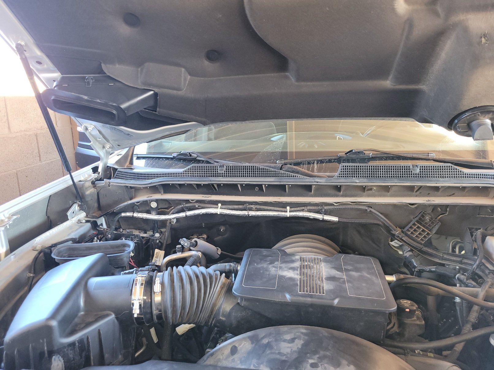

Converting an L8T hood to a functional L5P intake (functional hood scoop).

It's only a 1.5 foot run. As ghetto as it sounds I might try a Fernco and 4" PVC run and if it works wrap it in carbon fiber tape or at least it will be a mock up for a spendy silicon pipe. I don't mind losing the big ugly Hemholtz. Will allow more intake noise. Just need to adapt (or delete) the PCV feed from the valve cover in that case.
