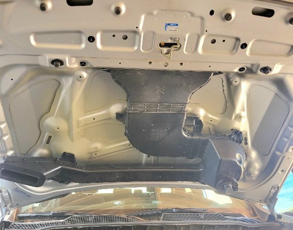

I think money might saved on the vent with some elbow grease. If you look close between the closed and open on the back, it looks like the closed could be an overlay fastened to an open one. Might try to chop mine up with a Dremel or blade in the front to open it vs spending over $150 on essentially what I have already. If I mess it up, oh well I needed to get one anyway.
Those bolts listed are outrageous at $10-14 each and some sites say unavailable. I'm going to try some Amazon ones that are a touch shorter. GM uses zinc M6x1.0x30mm. I got like 20 of them dog nose with the washer on them like stock for peanuts in comparison, although they are M6x1.0x25mm. Also the nut retainer things they screw into. So far with the bolts/nuts, hood blanket, push pins, air box, and front duct cover thing I'm into it $206.05 with 15% off and everything but the Amazon bolts/nuts shipped to a dealer to avoid the massive shipping costs on the various discount sites. The scapped OEM version of this posted by newdude lists for $800+.
If I can mod my stock hood vent, get the airbox to sync up and collect the main and upper duct I could get this done for half of that potentially.
Stay tuned.
Edit: After looking at my vent from the front up close I think it would be too much work to cut clean. Sickening to spend $112 + shipping on a new one but it is what it is.

Found a lower duct. Out of stock everywhere except a single dealer (tons of dealers around here). However, I doubt they have this "in stock" on the shelf. It let me order it though even though dealers less than 10 miles away it would not. GM parts research and ordering is such a laborious and confusing mess.
Edit: I'll be darned. Was on the shelf I guess. Got a ready for pickup email lol. Dunno why they would have that laying around, but there ya go.
After some tail chasing and gathering from 3 different sources, I've got everything ordered. Beyond what may be required to mod the airbox to TB connection, and relying on those ducts coming with the insulators and drain plug attached, I'm all in right now at $598.21. Compare that to the unreleased GM version at a discounters listed price of $809.68 pre shipping ($995 MSRP). If I can get this all to work I'll post a list of exact parts needed for the full swap.

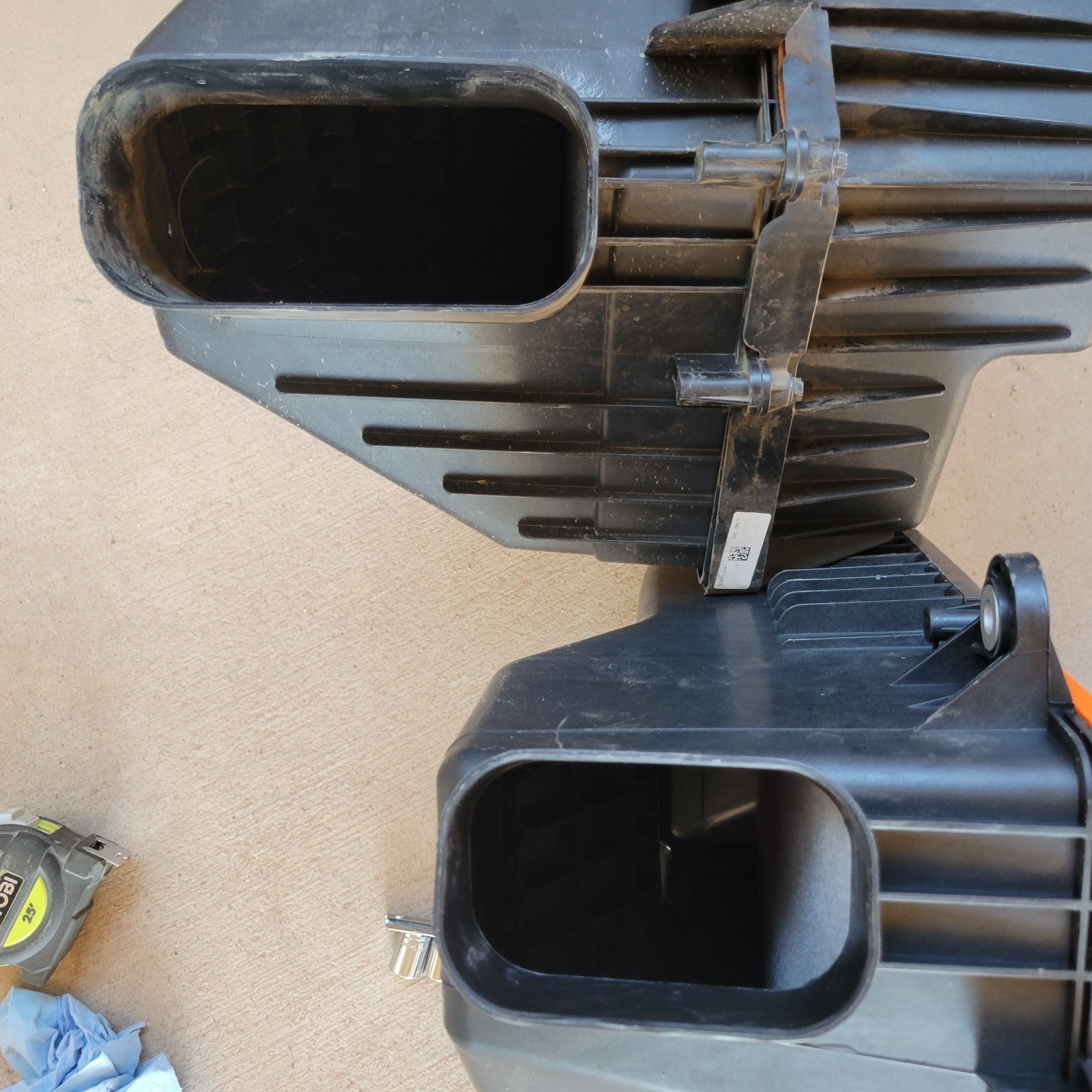

After an annoying process involving GM corporate and phantom missing parts I finally have all the things I need to keep going. Upon brief inspection it looks like the diesel airbox might be a direct swap for the gas one. That has me considering returning the GM box and getting an S&B dry to eliminate the Hemholtz resonator. I can't imagine the throttle bodies are in the same spot though and the aftermarket intakes have solid formed tubes. It might involve cutting and making a custom silicone intake tube like I thought I had to do anyway. So, on third thought, if this is drop in, I'll stay with GM.
Stay tuned for results and a complete part numbers needed list if this all works out. Looks promising though.20240607_114814.thumb.jpg.358f46b9c387bee31dce654613506140.jpg
Front intake feed tube is different.
Gas is ~6.25x3" OD
Diesel is ~4.5x2.75" OD
When newdude mentioned a separate box PN for the cancelled gas intake kit, a larger lower opening to match the stock gas feed tube was probably it. Everything else like MAF placement and bellows looks to line up though.
