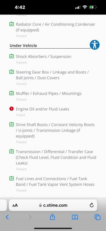

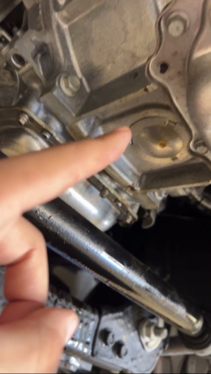

I have a new 2024 GMC Sierra 1500 Elevation with the Turbomax motor. Everything has been fine to-date, but yesterday noticed a few drops of oil underneath my truck. Taking a closer look, it appears that I have a fairly significant oil leak, but can't really tell where it's coming from. There are drops on different sides of the oil pan and lower transmission pan...and a general film of oil on a good portion of the rear engine and transmission areas (probably blown back while driving. I'm taking it in to be checked tomorrow, but wanted to see if other are having similar issues and had any specific results from having it repaired. And sorry if this is a duplicate topic from another forum, I did not find the same issue anywhere else.
In the photos attached...you'll see the areas where the oil is dripping, pooling, and general spread across the underside of the truck. Tough to tell what exactly is leaking, but I'm sure I'll hear more tomorrow. Hoping it's nothing significant and just a simple tightening a loose screw...

I'm gonna guess rear main seal.  I've seen a few reports around of this the 2.7  (and 3.0 Duramax).  Not every single one doing it of course, but there's a couple out there.
If it is that, they will replace the entire rear cover/seal assembly.  Could have been misaligned during engine assembly or rolled the seal somewhere.  The cover itself is RTV sealant for the perimeter gasket so could have a bad spot of RTV.

Wish I had better news. After more than a week with my local dealership service, I as told on Friday that the truck was done (at least that's what I was told.) The main rear engine seal was "rolled" during manufacturing, an "assembly defect." There was also another seal leaking, but I don't recall which one that was. Most all of the drivetrain was removed as well as the back of the engine (bell housing, etc.) to get to the seals...then put back together. It's a very uncommon failure...and something almost never done at a dealership...so hopefully it was reassembled correctly. Everyone said it was quite an issue to repair and rebuild.
