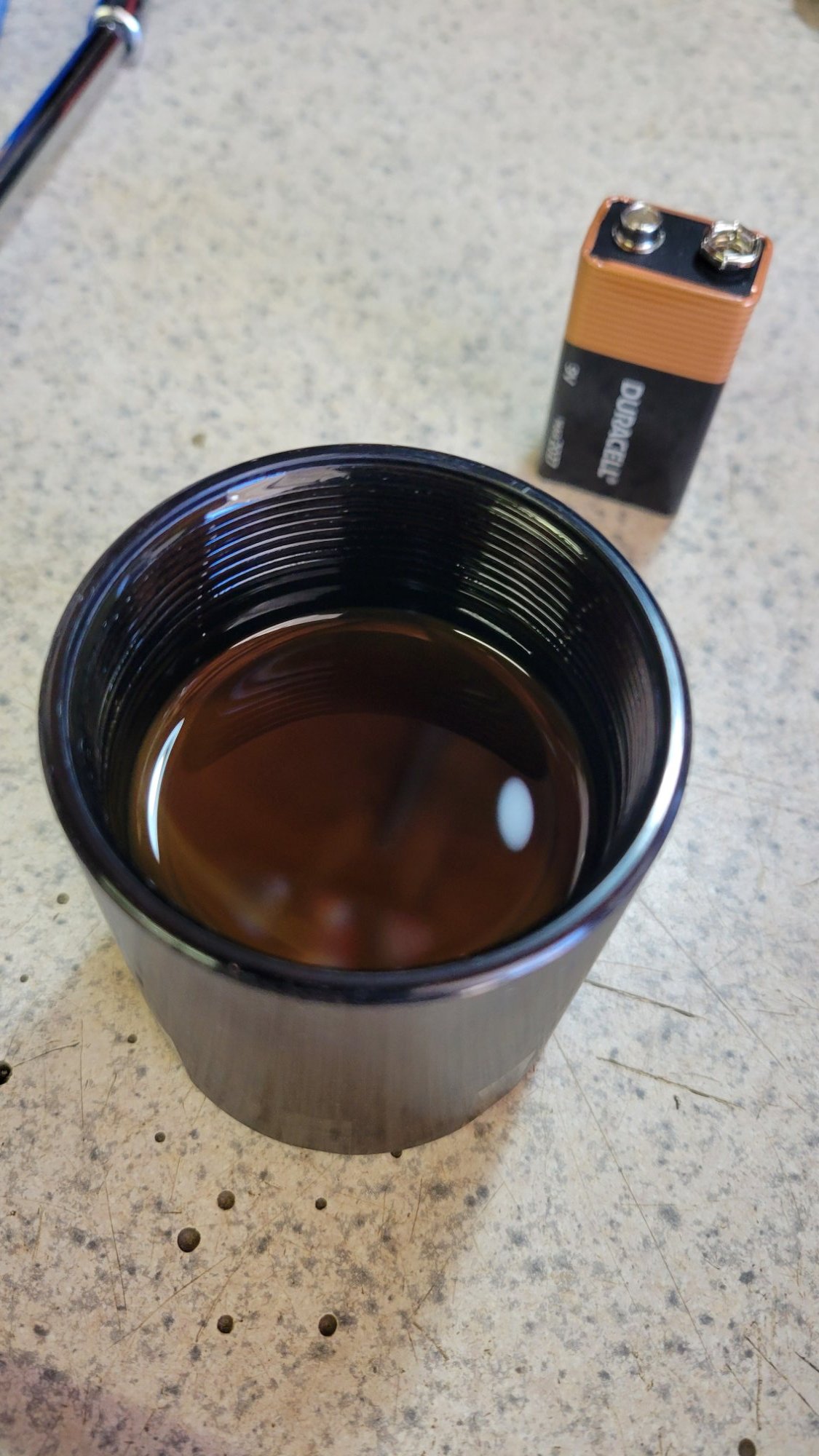

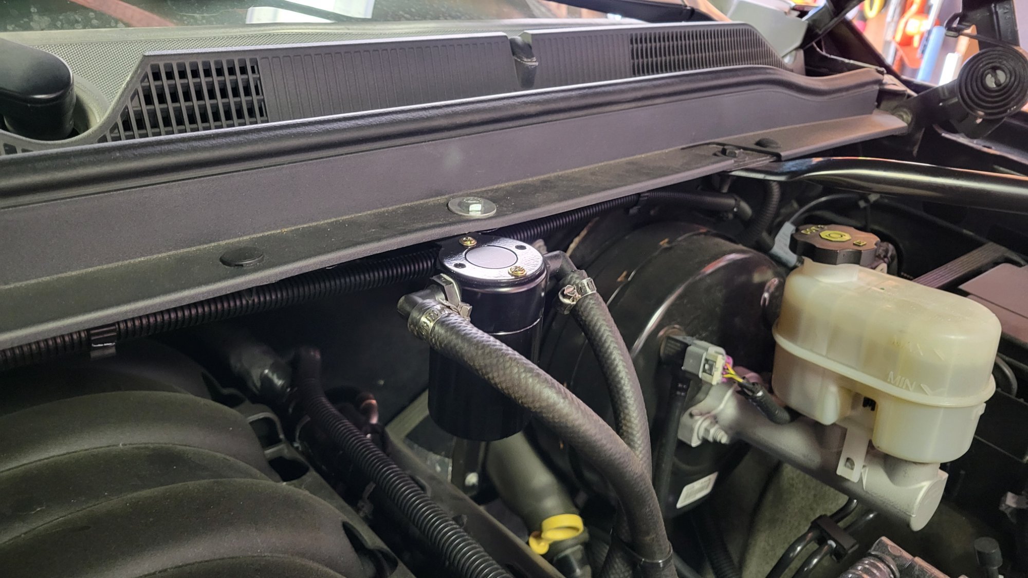

I installed this oil catch can only 3,474 miles ago. It was installed 1,213 miles after the last oil change.  I had not checked it until today when I did an oil change, and I was surprised to find that it was full, up to the treads!  I can't imagine it was very effective if it was sucking in its own excrement.  There was only a very small amount of "milkshake" at the very bottom of the catch can that was visible once I drained the contents.  I use Kirkland Signature (Warren Distribution) 0w20, and this is a 2019 model year 5.3 AFM engine with nearly 69,000 miles.  Thoughts?

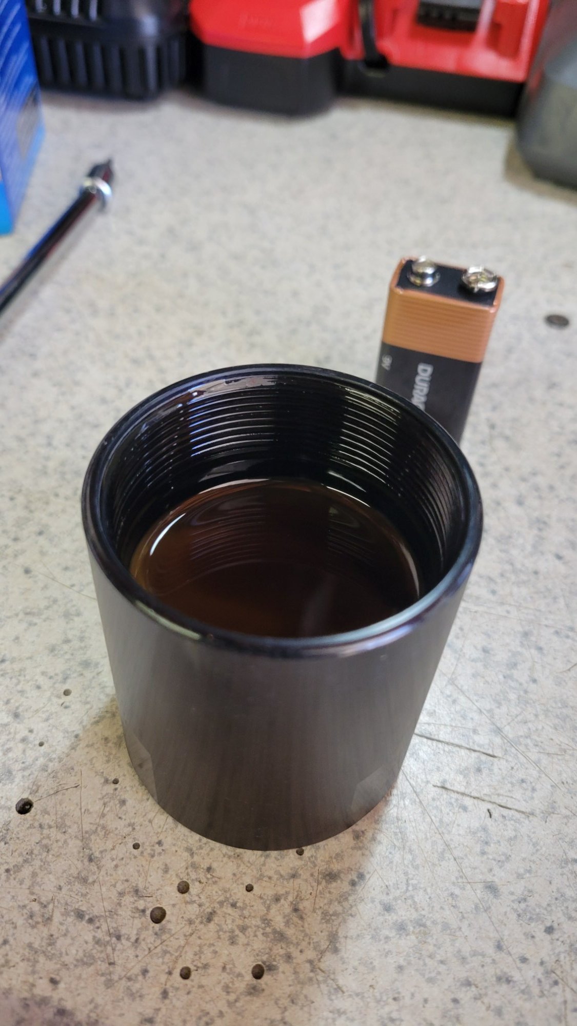

I just checked my catch can way early this time, only 428 miles post-oil change, and was surprised to find a bit of what appeared to be fresh engine oil (looked just about the same as the oil that went in, no water.)  I did not measure it out, perhaps next time when I'm expecting it.  For the last oil change I used 7 quarts 0W20 Kirkland Signature (Warren Distribution) and 1 quart Marvel Mystery Oil.
Seems to be working fine IMHO.

Hope so, seemed to be more oil than what I would have expected for so little miles, also no frigid temperatures or short driving trips either.

Milkshakes yes - but straight, clean oil??
