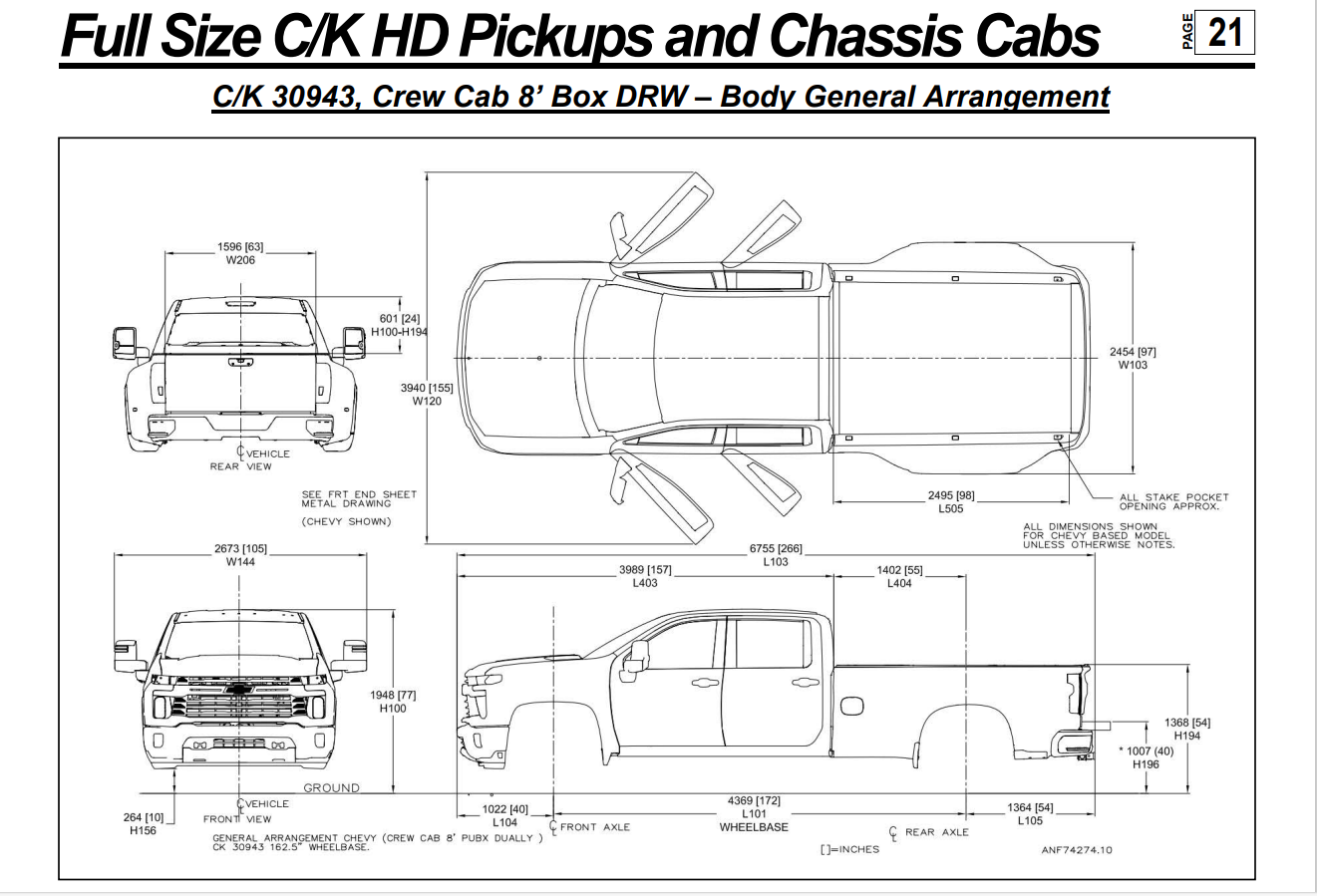

newdude Posted April 3 Share Posted April 3 (edited) 14 hours ago, HighTowing said: I am comparing my truck to a 2024 GMC Sierra Denali 3500HD Dually. My truck sits 2 inches higher than the GMC. Both are dually, both are diesel, 4wd, neither has the snow plow or camper package. Smart @ss question...were both on the same level ground and next to each other? How did you measure? Going off the data in the upfitter book, you should measure 54" at the top rear of the bed rail from the ground measuring off of a flat, level surface. . Both the HC and the Denali in dually form, there should be zero difference in height as they are the exact same trucks underneath. Same frame, springs, axles, etc. The duallies even both use the exact same pickup boxes. And both are on those new 18 inch wheels they use which use a 32.8" tire. The only other plausible difference is if its a 2020-2023 that has the 17" wheels which use a smaller tire (31.8"). Edited April 3 by newdude Quote Link to comment Share on other sites More sharing options...
