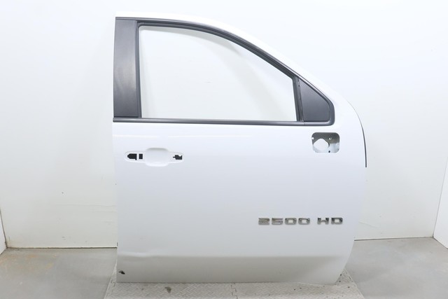

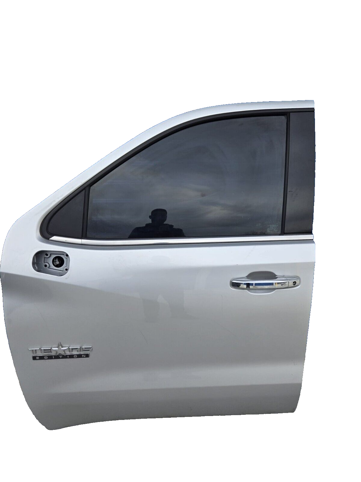

The 1500 doors are different Chevy and GMC.  The angle of the mirror mounting plate and shape of the mounts are designed to contour the doors.
The HD doors are flat, no body lines at the doors.  The mount and the studs are positioned differently from the 1500s.  You can see the differences below in the mount holes on the doors.
Silverado/Sierra HD door:

Also GMC 1500 door for refrence:
2019 2020 2021 2022 2023 2024 GMC SIERRA 1500 FRONT LEFT DRIVER DOOR SHELL OEM - Picture 1 of 12

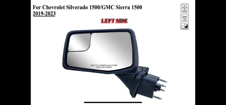

So just to go back to something I posted earlier, there is one small mirror option for HD from the factory.  Option code is DLN, they are power glass and heat.  They can be used, however, if you have either version of the tow mirror that has the blind spot indicator, these would be a no go.
What functions do your current tow mirrors have?
Just turn signals and heat, no blind spot indicator.      Any chance you have a link to a picture or a part number?
