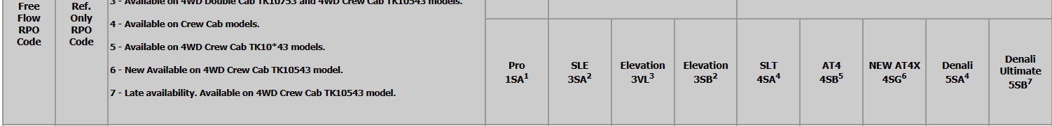

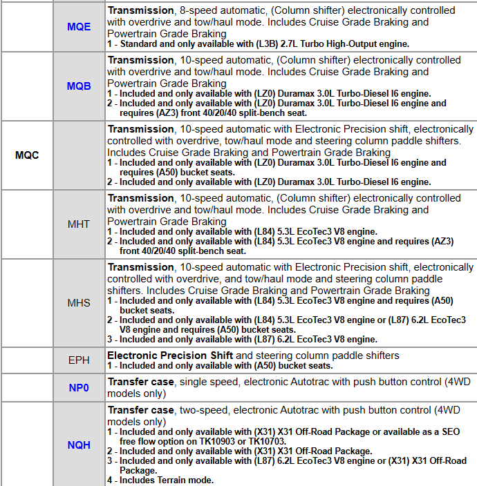

I think someone is misleading you.
On 2023 Denali Ultimate, the
- 3.0 has MCQ
- 6.2 has MHS
and the NHQ transfer case  (the 2 speed one)
(8 speed, and column shift version applications also shown for completeness.)
Probably hard to read with usage chart so without chart --

MHS with the 6.2 as GETGONE makes note of.  MQC is 3.0 Duramax.
The 1500 10 speeds are all a 10L80 at the end of the day.  Just comes down to what engine they are paired with (dictates torque converter and programming specs) and how they are shifted (column shift with cable or ETRS shift by wire so different valve bodies and wiring internal) which makes up the differences in them.  Other than that, all 10L80s.

Its MHS.  Read the description again.
MHS - Transmission, 10-speed automatic with Electronic Transmission Range Selector, (ETRS), electronically controlled with overdrive, tow/haul mode and steering column paddle shifters. Includes Cruise Grade Braking and Powertrain Grade Braking
Included and only available with (L84) 5.3L EcoTec3 V8 engine and (A50) bucket seats or (L87) 6.2L EcoTec3 V8 engine.
"Included and only available with 5.3 and 6.2".  The MQC transmission is "Included and only available with (LZ0) Duramax 3.0L Turbo-Diesel I6 engine and (A50) bucket seats".
ETRS is the shift by wire console mounted shifter.
So 6.2 Denali means you have a console which automatically means you have the ETRS shifter and therefore the MHS transmission RPO code.
