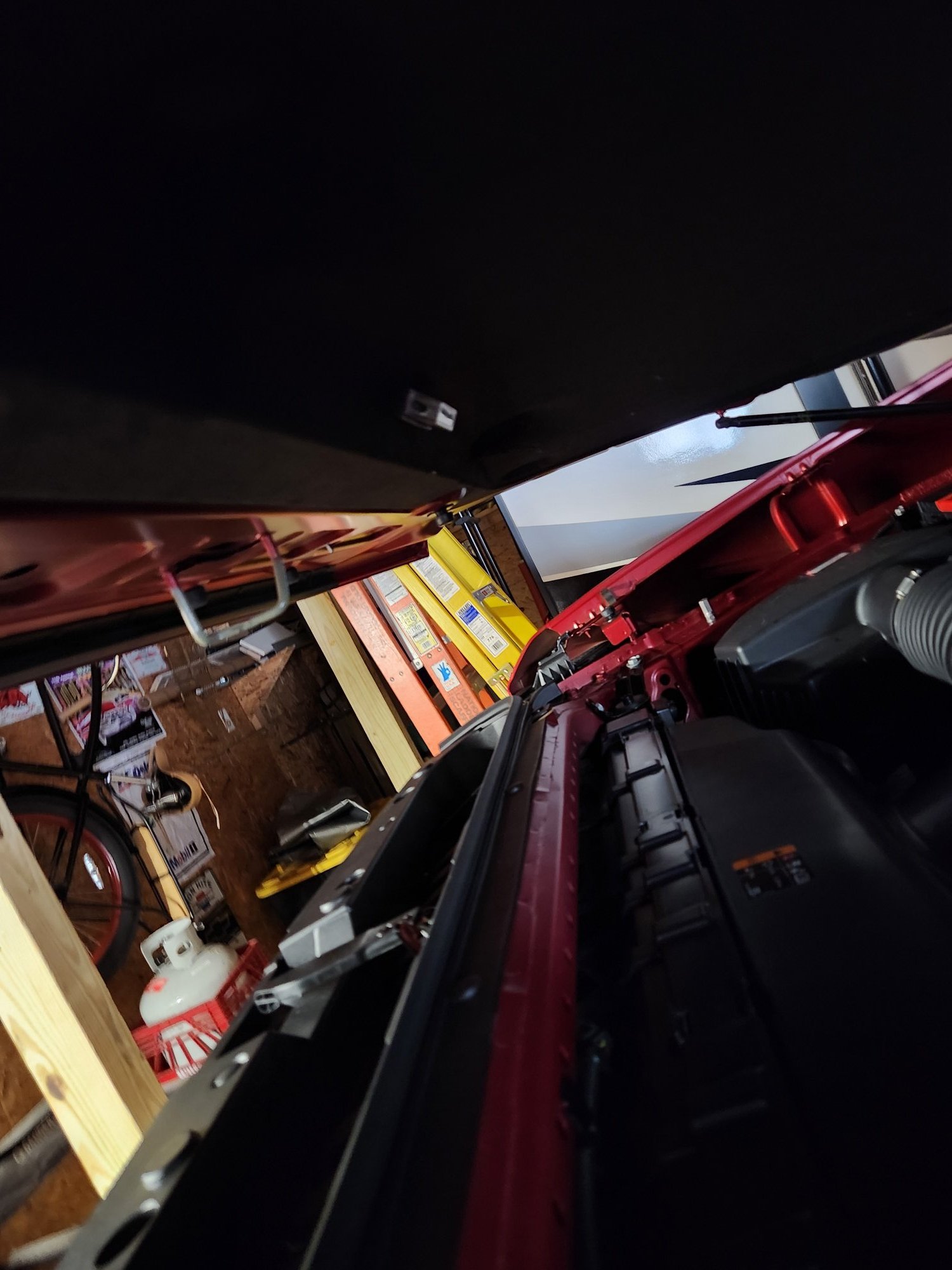

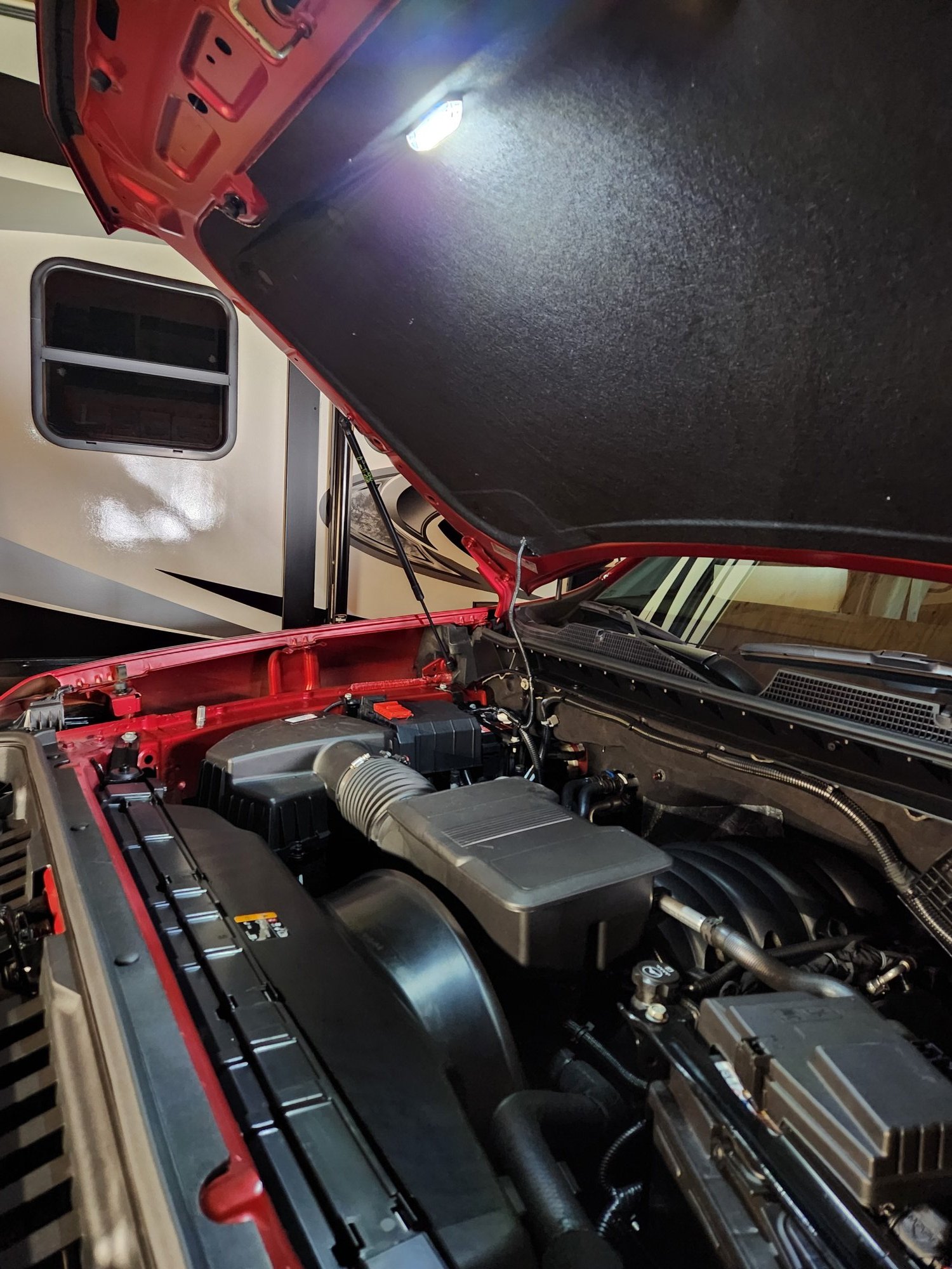

I ordered a led strip light and switch from Amazon.  B08R1PC8F4 this item was a single strip with a plunger switch that mounts to an open hole just under the hood on the passenger side I just wired it to the Aux battery and it works great. I believe they have a dual led strip version now.
I used a simple LED light and zip tied to the insulator, ran a power wire behind the insulator down to the passenger side cowl and pulled power from the distribution box. The ground wire runs to a magnetic switch under the insulator and connects to a ground near the battery. You might have to adjust the ground switch to get it to come on exactly when you want.
