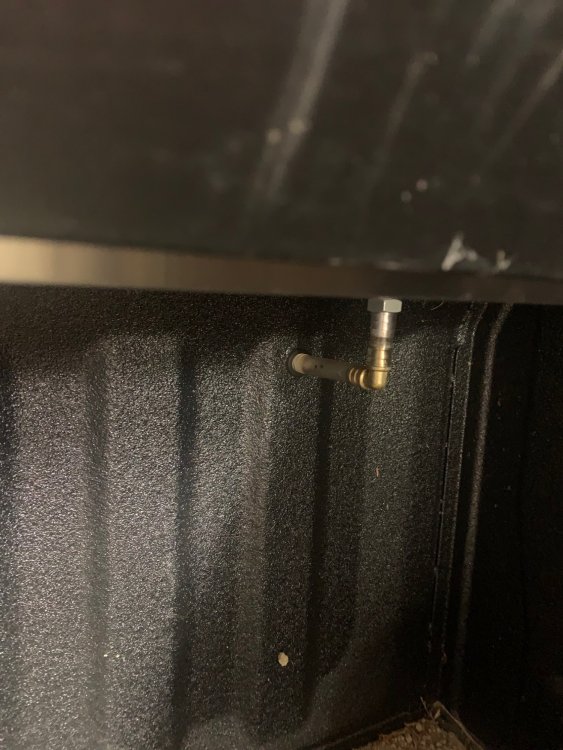

I also put a picture of how I did my drain tubes. It's just a 90* elbow and then out the bulkhead and down the inside of the bed. I can get a picture if you want it. On my previous truck I have the drain tubes running down to the bottom corners but I found I kept pulling them off the canister when I would put something in the bed. This way they are tucked up and out of the way.

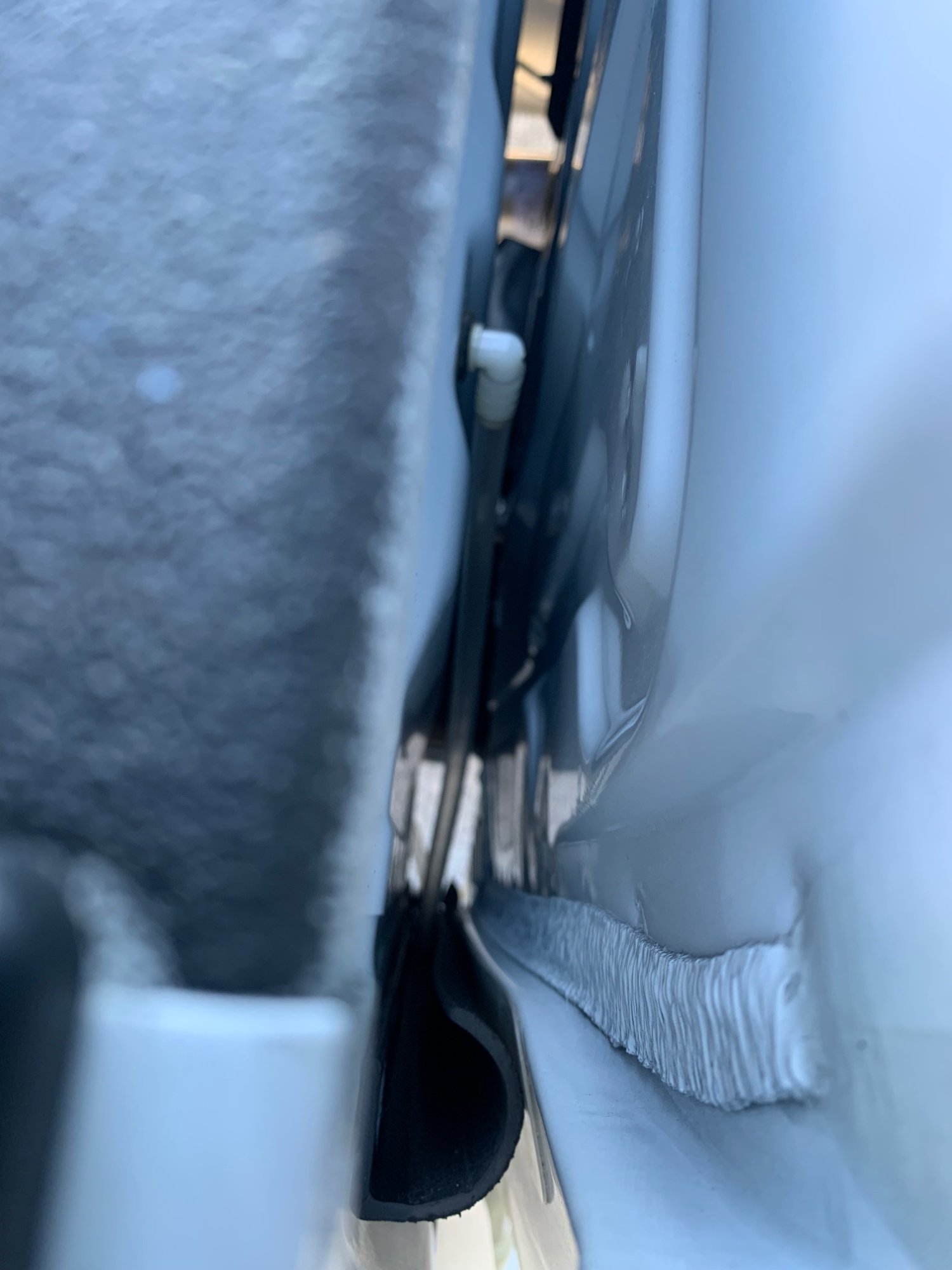

You’re right. I got it backwards. Here are some pictures of how it’s routed between the bed and cab.
When it gets close to the bottom, I ran it inside that c-shaped black filler piece and used some zip ties. The picture is deceiving but the tube is about flush with the bottom of the bed.
As for the canister, it sticks out about 9.5 inches and then has an upward angle that’s sticks out about 11.5 so that’s the furthest it sticks out. As for space between the bed floor and bottom of the canister, that’s about 15.25”.

Holy crap, you sure were meticulous running the drain tubes. I assume you made the same effort on both sides? I just wish I could run up to the holes that are already in the bed walls. I'm leaning more and more towards the Roll n Lock for the ease of opening and closing, opposed to flipping panels, and if I pull the trigger, it's certainly nice to see what you did because for some reason I dread drilling additional holes in the bed.

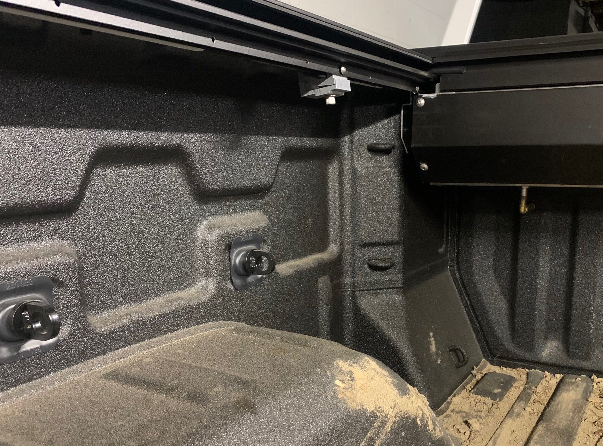

Ha ha. Yea, I might have gone a little overboard on the drain tubes but I had the 90* elbows already and figured why not. Plus with how high I wanted to route the tubes, the tubes kinked when running them without the elbows. I also didn't want the drain tubes rubbing against the back of the cab (probably wouldn't have been an issue). I wanted to use the holes in the bed walls as well but the RNL brackets use those holes.
You should have enough access to all of the tiedowns but I also bought some tie downs on Amazon for the bedside holes just to have more options.

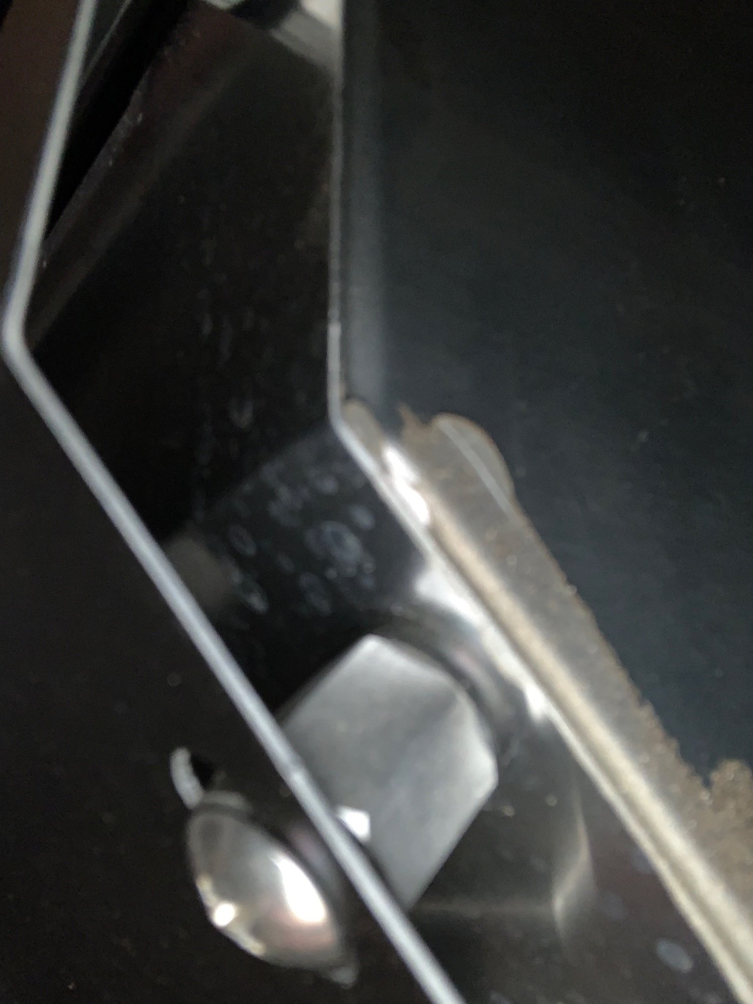

The canister actually has a shield over the front to protect it. While it's not the strongest it definitely helps and can be replaced it damaged too much. When the canister is fully opened, it sits pretty much flush with the front of that canister shield. If I remember right, I think the Retrax cover overhangs the canister by a few inches. I would think it would be ok to have something jammed against the cover but can't say for sure how sturdy it would be for long periods of time.
Hopefully these pictures help answer some of your questions.

What is this pic of?
And, yes, I don't like how the Retrax cover takes up even MORE room, the way the cover doesn't retract all the way like Roll n Lock does. So, the canister is hunge, AND it eats up even more room in the bed by virtue of that cover sticking so far out into the bed.
Thanks for additional the pics of the canister "shield", and the view of the stock tie downs. That really shows how much less room the RNL canister takes up.
BTW, I meant to ask if you have the short bed, because seeing your video showed the stop positions well, and those stops look like decent points to stop at. Based on how it LOOKS like the latching system works, I would THINK it wouldnt be that hard to mod the tracks a bit to add more stop positions if someone really wanted to.
Thanks for the additional info on the canister using the stock holes in sides of the bed. Using elbows for routing to the drain holes was a smart idea. I noticed you also used some kind of bushing in the drain holes you made. What did you use for those?

I have the shortbed. On the stopping positions, I think it can be done. I'm not sure if it was on a GM truck, but I remember seeing a how-to and video where somebody did this. I'll see if I can find it.
The bushing is just a grommet so the tube didn't rub on the cut metal of the hole. Before I put the grommet in, I cleaned up the edges as best I could and coated it with touch-up paint and a little silicone.
