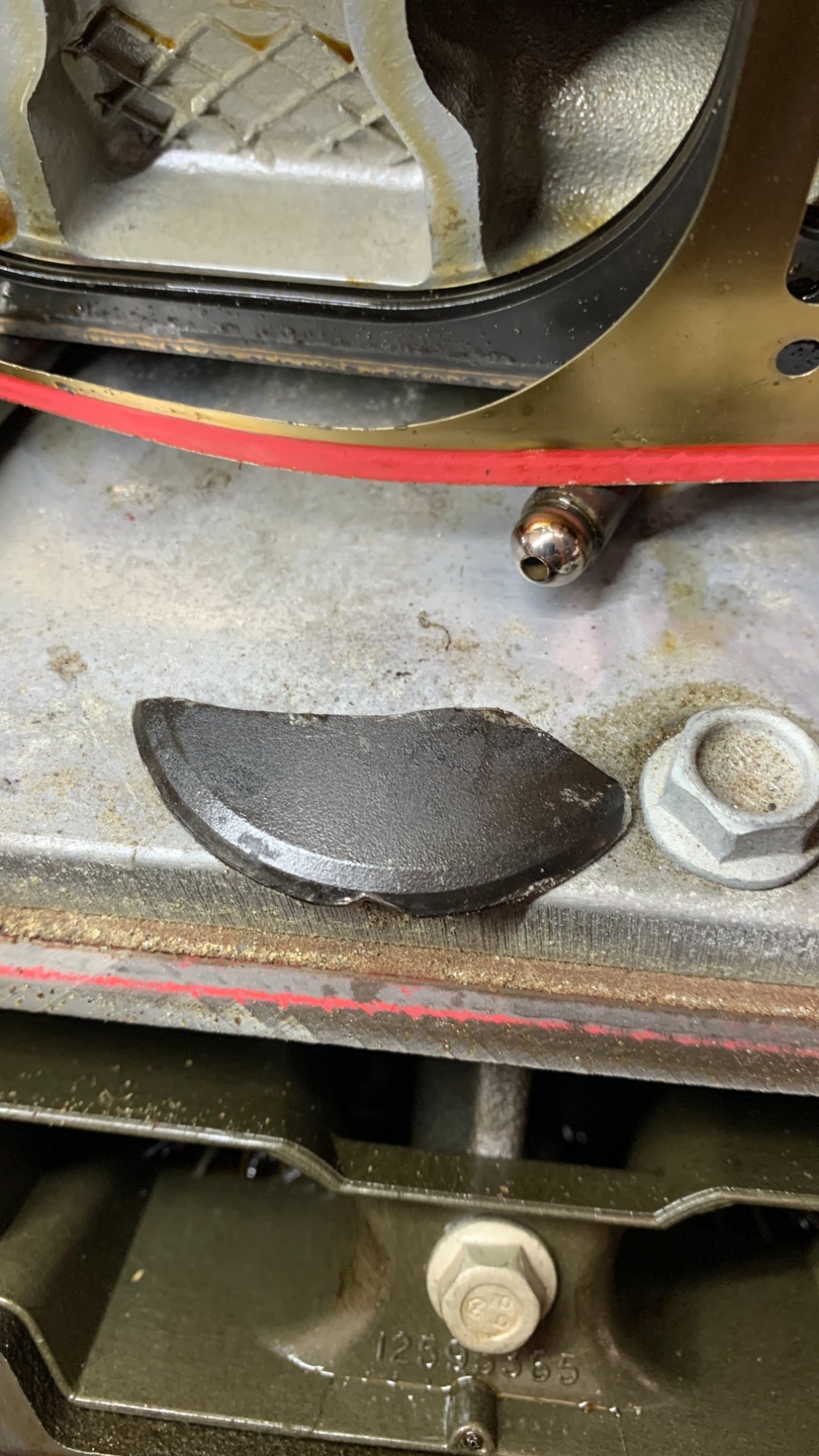

I'd say 4 years in and 95% of the 6.6 HDs we've seen though the shop have been trouble free.  A few with bad oil cooler lines, two for oil consumption which, had leaking oil cooler lines.
We did however just replace one and are working on another.  The first one we just finished, customer had their oil changed just over 80k mi and the shop that changed it said the oil was full of glitter.  It was running rough too.  That one just got picked up, fresh long block.
The other one, the tech is working on the install of the long block.  2021 Express 4500 school bus, I think 43,XXXmi?  I have pictures of that one.  It straight up broke a 1/3 of the valve off, which that then bounced around and the tech actually found it in the intake manifold.
Don't see it happening IMO.  Also, L8T makes 20 less HP and only 4 more torque so 10L80 wouldn't have a problem behind it.
Both of those look abused....
This is not as widespread...as lets say, the 7.3 Godzilla camshaft delamination problems (which I am not sure still happens on the MY24s....).
The first one with 80k I bet was.  The bus with the pictures I posted?  Most of the bus garages we deal with, they have great maintenance records (which were provided), and with the way that valve is broken, to me, it seemed more a metallurgy issue (weak valve casting by the stem area).  It wasn't like an injector stuck and melted the valve, the valve straight up cracked.
Then I suspect it might have been defective from the factory....or the person was unlucky.
