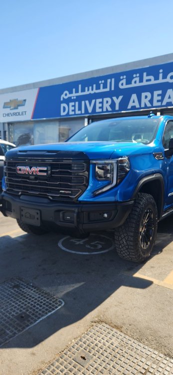

2024G MC AT4X with the 6.2 engine Should I be concerned about potential lifter failures
Hi, I'm currently considering purchasing a GMC AT4X with the 6.2 engine, and I've heard about potential issues with DFM (Dynamic Fuel Management) lifter failure. Can you provide more information on the reliability of the DFM system in this specific model? Should I be concerned about potential lifter failures, and are there any preventative measures or updates that have been implemented to address this issue? Thank you
