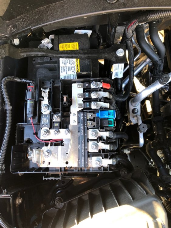

Here’s a picture of the top of my starting battery on my 2021 3500. I have an aux battery, 220 amp alternator, and an added wire to my camper on the 80 amp fuse, so yours might look a little different. I haven’t had mine out but I have disconnected the fuse block from the battery. I suspect that, to be able to pull the disconnected fuse block out of the way enough to lift the battery out, you may need to disconnect the small connector on the left side of the picture.  B44CF5B5-B1B7-4DD7-856B-FAD90639BBDD.thumb.jpeg.09eafb66a23244b18f5abe7d2e4357fc.jpeg
Thanks JR.  So you had that fuse / wireblock off?  How do you get it off?  Is there a bolt?
Mine looks just like that.  I pulled the top off with the two tabs and it revealed exactly what you show above.  I can grab that wire cover and it seems loosely mounted, like by a bolt somewhere.  As it does move but it sturdy.

You just loosen the positive post connection and the fuse block lifts off, subject to the restriction of all the wires. Almost all of them connect on the engine side of the battery so as long as you disconnect that one outboard connector you should be able to lift and push aside the fuse block enough to get the battery out (after removing the battery hold-down).  It might help to have a second person help you manage the wires and block while you lift the battery - even more so when you go to put the new battery in.
