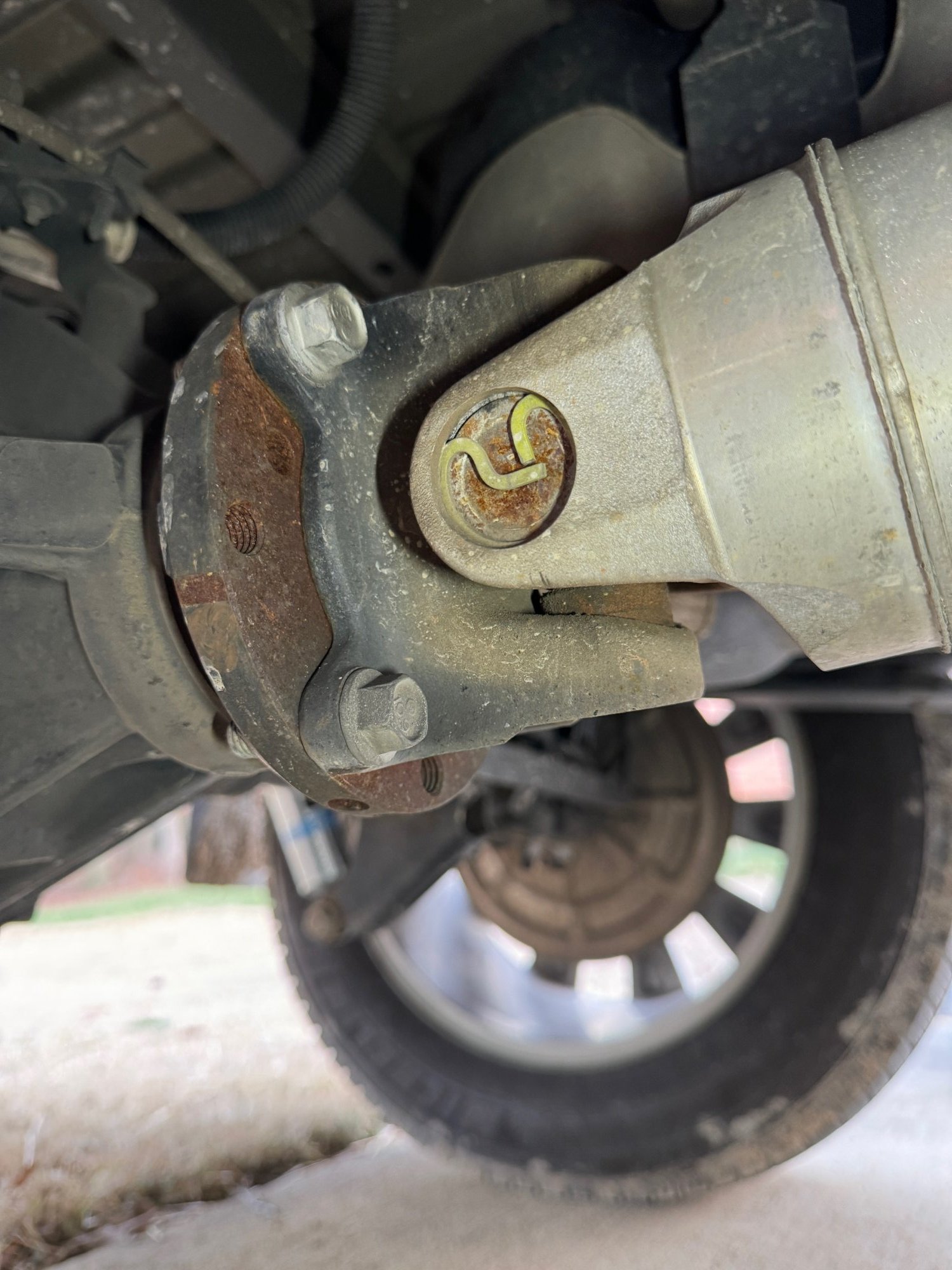

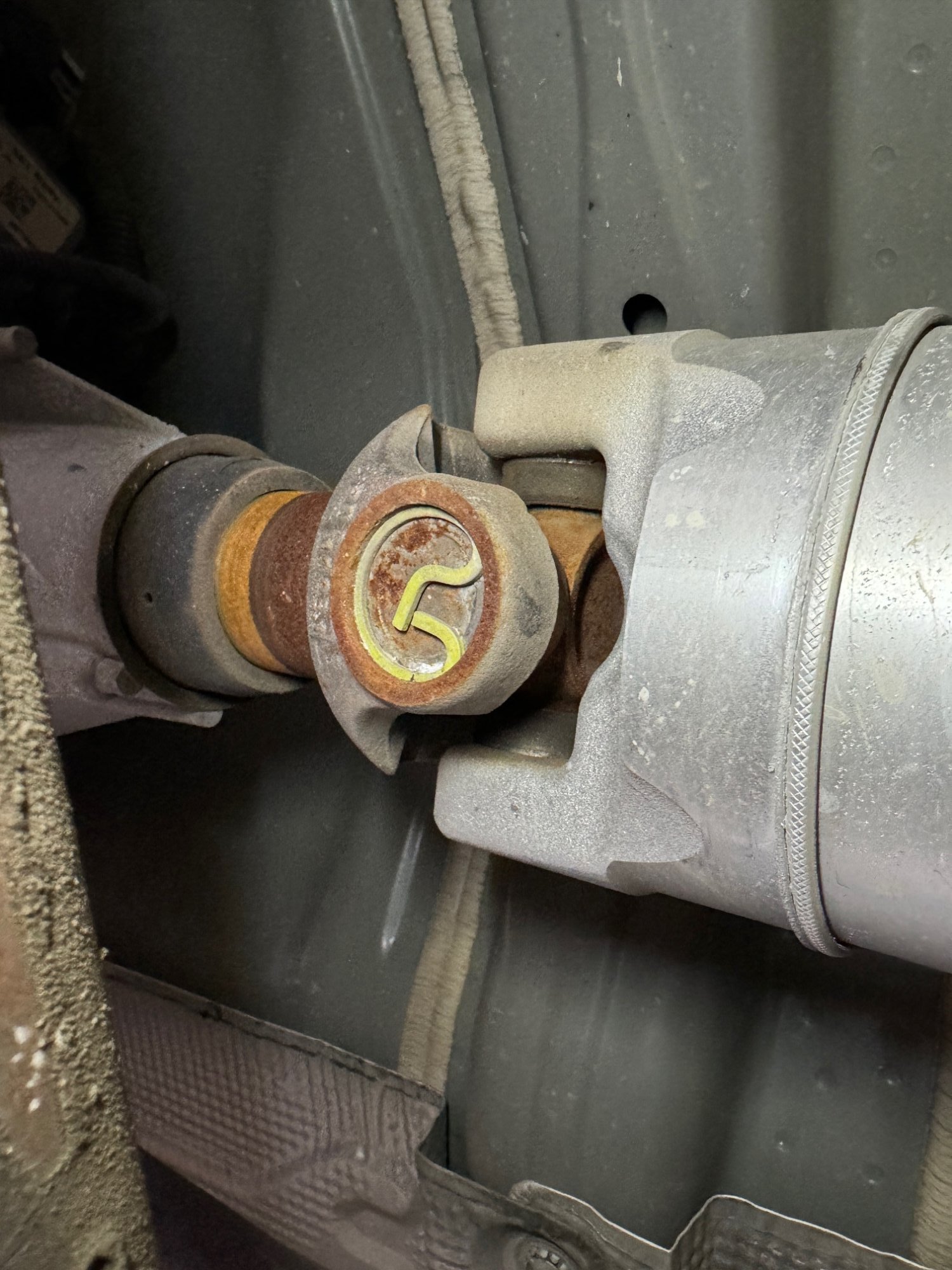

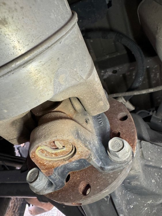

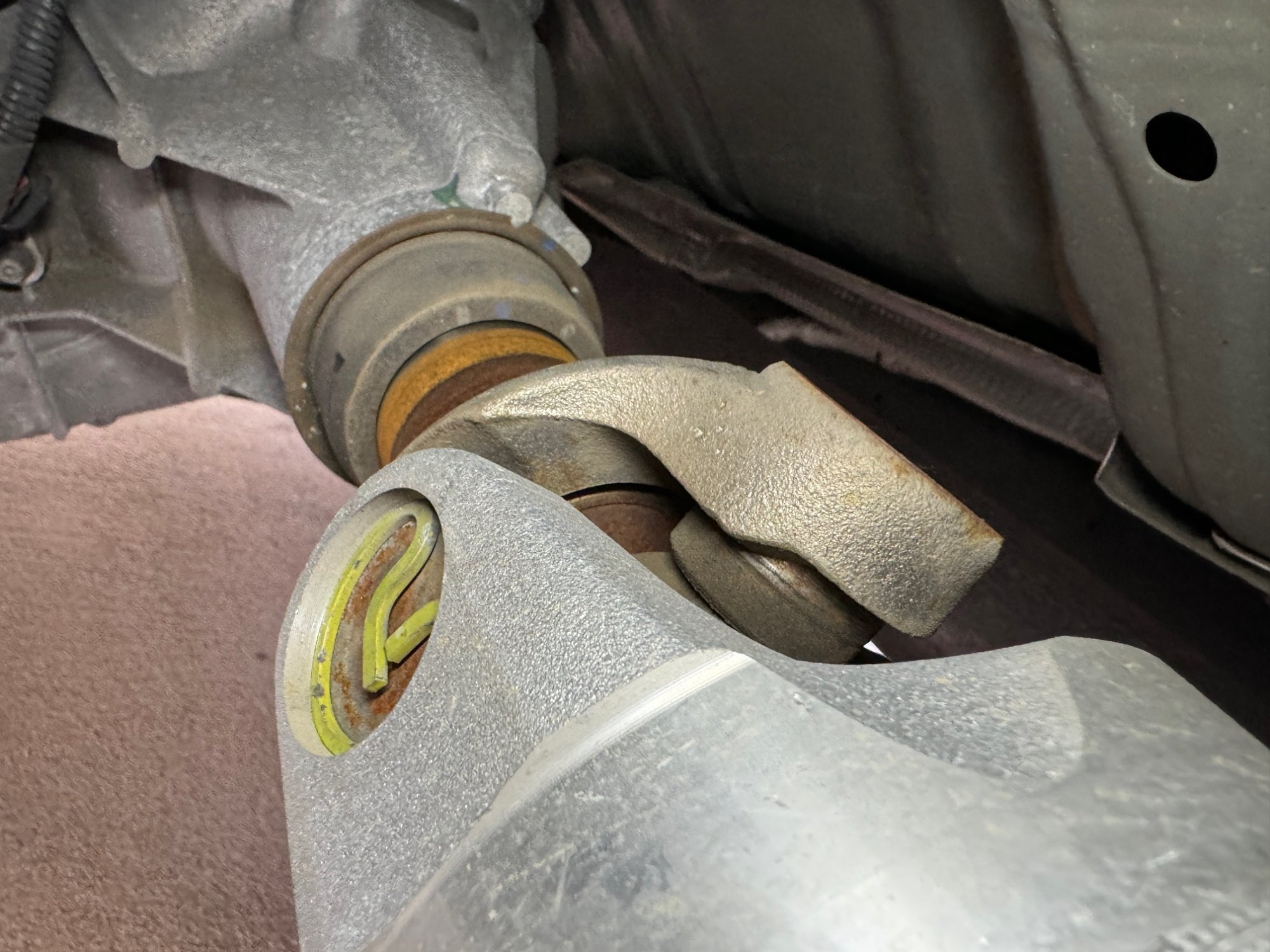

I popped under the truck to inspect the u-joints. I checked for play by hand, none apparent. The rear u-joint has some grayish dust/grease around it. Maybe that’s a sign it’s going bad. I should have taken a picture. I’ll go out there later again and get one.

Here are some photos of my u-joints. You can see the grayish dust/grease on the rear u-joint. Not as much on the front one, but a little.
REAR
FRONT
