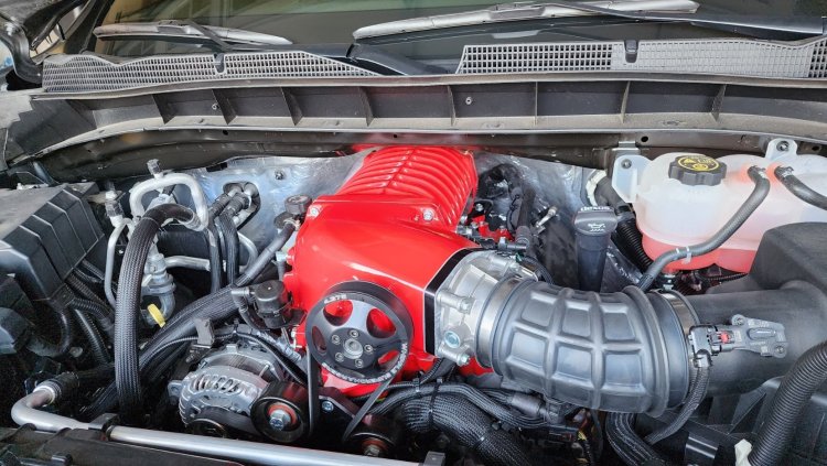

I searched for about a year, including posting here looking for references, and finally found someone who had a solid reputation to do it and pulled the trigger on purchasing the Whipple in June of 2023. However he was 3 months backed up, so it didn't go in till middle of September 2023 and I got it back a few weeks later when I returned from vacation.
At the urging of the shop owner, I opted for the Trans tuning as well and I'm certainly glad I did.  There was a few hiccups along the way, mostly logistics between HP Tuners and Whipple, but in the end it was all sorted out. I also splurged and got the red version.
It certainly pulls and I had a lot of fun driving back home and since. The tune he did on the Transmission made a world of difference too. Shifts are crisp and in the earlier gears, harder and more concise. When just driving around town, it shifts earlier in the RPM range and I like it alot. The SC itself is pretty quiet. I can hear it because I'm used to it, but friends I've taken for a ride can't really tell unless I point it out. I wish it had more of the SC whine, but I can live without it. Like AEMedic mentioned in his SC build, I think the Whipple tune leaves some to be desired. It has some surging and I mostly notice it under light loads up any incline at cruising speeds. It's like it doesn't know what to do under certain circumstances. It's a minor annoyance for now which I plan to have tuned out later this year.

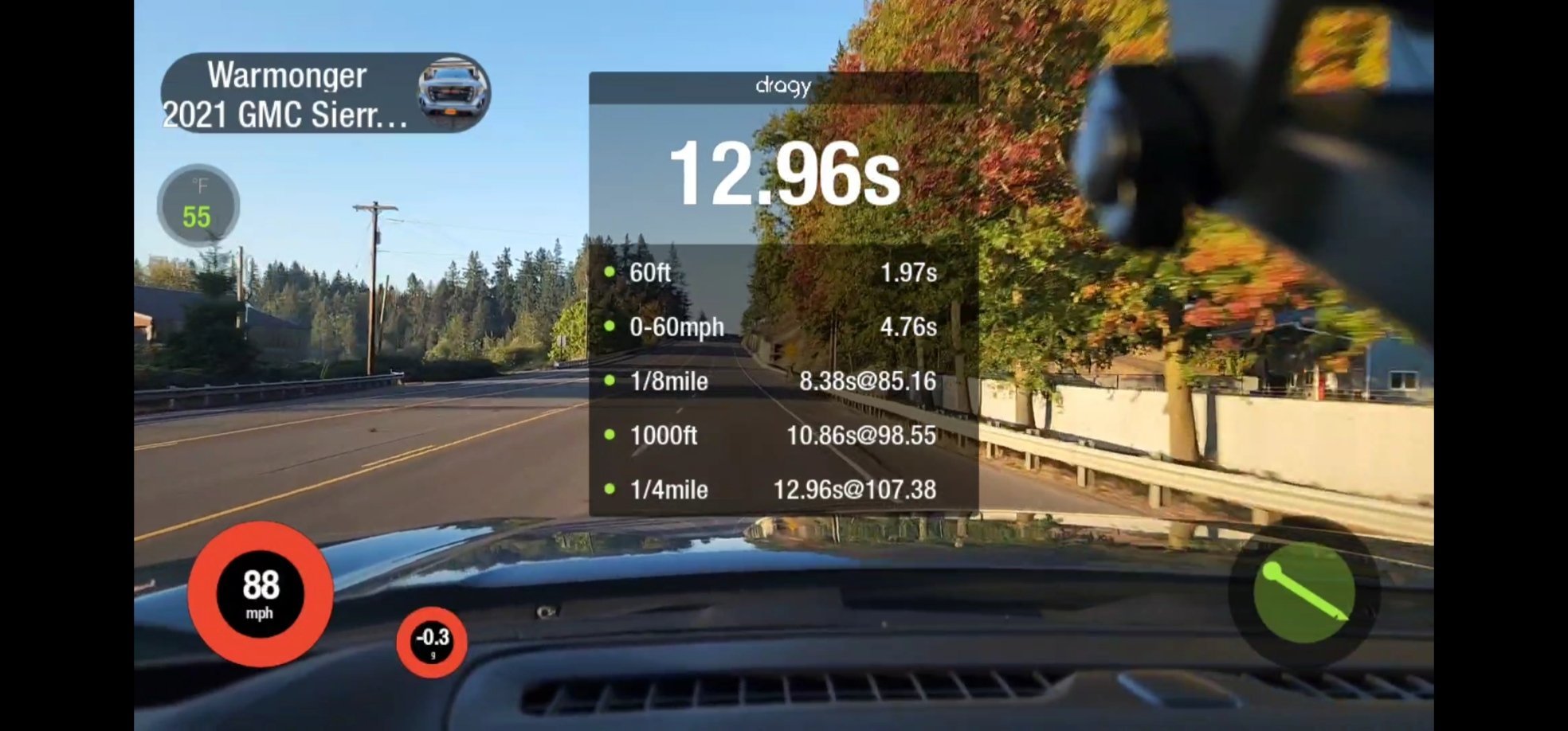

Since around 1000 miles, I've had the AFE CAI, Borla S-type cat back exhaust and the Edge Pulsar LT module installed. I knew the truck felt fast, but I really didn't know how fast. I bought a dragy several weeks before I drove it up to have the work done and got a baseline of what the truck could do in 0-60, 1/8 and 1/4 in a spot I've found that is 3/4 mile long and is around 112 feet in elevation. Did about 12 runs over several days. They were all done earlier in the morning and with 3/4 to full tank of fuel. I also should note that I have the 6.5' bed on mine.
When I got it back, I did the same thing over a few days and was pleasantly surprised at the results. Attached are a few screenshots.
