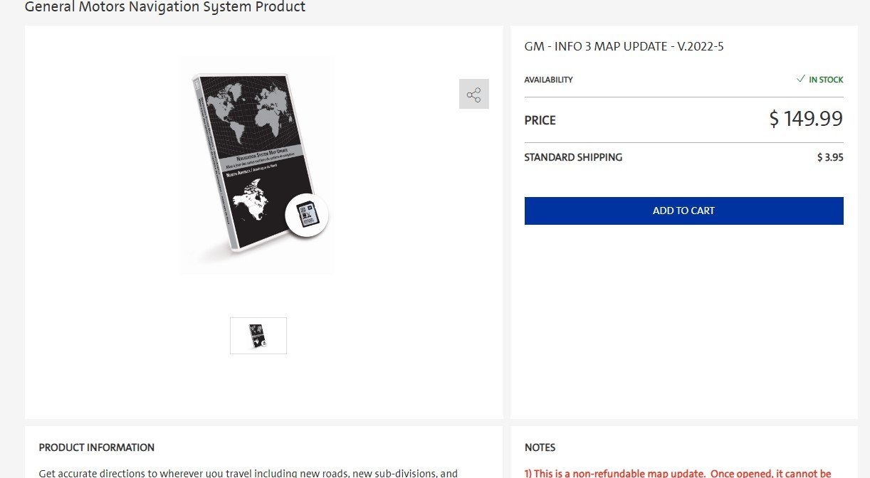

Google gmnavdisc and you'll find:
That's the same source the dealership parts department uses.  Their price is substantially higher because they want a profit.  They don't get a discount.  Over a decade ago I was an aftermarket parts supplier to several dealerships.  I built relationships with managers and parts personnel at several dealers.  They informed me they marked up their items by 70% to net a 40% average profit.  If you can utilize the same source and save a bunch of money, I'd do it.
