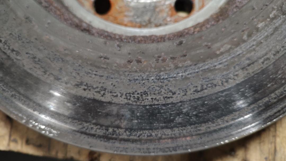

Started getting a slight brake shake just past 20k and just got back front trip and decided to change the front ones out at 33k as they were getting much worse. Wear was showing 89% left on the fronts. Changed rotors and pads out. Pads had alot left to them. Rotors looked good on the outside but the inner side had caked on bumps that was causing the shake. Was told from a guy I know at GM testing that its because of California mandates and its due to the compound that pads are using now.

I had the same experience with my 2019 Elevation. Rotors started to rust a bit on the inside and burnt the pads off. I have never had a new vehicle wear out brakes so fast. Mine was a daily driver so they didn’t rust from sitting.
What did you replace them with?
I went with Power Stop Z36 front rotor and pad truck and tow kit. After seeing what happened with the fronts I have the rear kit coming in for the weekend change out. Haven't done anything other than the break procedure on the fronts but they seem to do the job, we'll see....
Edited by Grover67
Rears got changed out today, rotors looked like the fronts but not quite as bad, 93% left on wear pad indicator. A little bit different to do. Set the brakes into service mode, disconnected battery and got first side apart. Couldn't get caliper back on. Called a buddy of mine, had to use a 12v battery to retract piston fully  and then was able to compress it the rest of the way to get caliper back on. Reconnected battery, took out of service mode and no codes. Will do break in procedure on pads tomorrow.   So their done now
