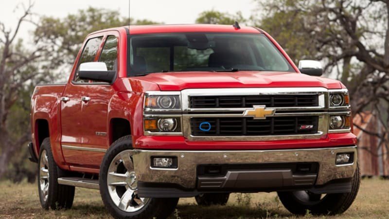

s-l1600.jpg.fe166471e6b56481531fe78aac38d85d.jpgLooking for install ideas with photos to add an AC Port plug to my truck.  I don't run my truck enough to keep my battery in topped up.  Planning on permanently installing a NOCO GENIUS 2D battery maintainer.   I found several examples on Dodge, Ford and older Silverados but not much for the 2014-2018 models.Screenshot_20231219_192530_AmazonShopping.thumb.jpg.a105808542b8ae1320f51298b0878a96.jpg

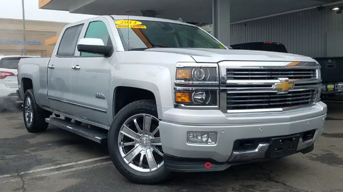

Thanks - very helpful.  My pickup is similar to picture below.  The silver does not leave much space for a hidden black socket.  I cannot fit it flush on the black area on either side of the license plate (side plate?) - the tow hooks are in the way.  I am going to try installing it on the air deflector as shown near the red mark for this picture, except aiming to do it on the drivers side.   If you have any pictures of a similar install from others, feel free to throw one up here.  It is getting cold up north, mine is to connect with the engine block heater....so I will probably install it in the next 1-2 days.
