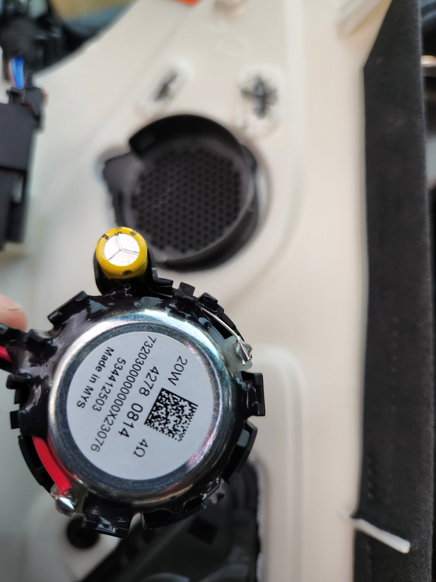

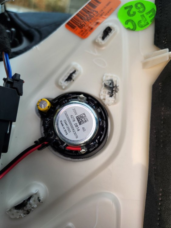

The Tweeters in the "A" Pillars and Denali Bose tweeters in the top of the rear doors, I think would be the same. I just pulled my Driver "A" pillar. Pic attached. They as the door speakers, do not say Bose on the Magnet Structures, or anywhere else on them.
You see a small Yellow Capacitor, that acts as the Crossover, to block the Bass frequencies, from blowing this tiny speaker. It is a 4 Ohm, 20 watt rated. Can barely hear it, with the Terrible 3 Band  EQ. Treble cranked to 100% . This also should at least be a 11 or More Band EQ., to Fine Tune this so called Premium Bose System.

This "A" Pillar Tweeter is glued into the black plastic housing that snaps into the Grill Bezel (which is heat welded into the "A" Pillar white cover). So a replacement has to be held onto the grill housing with 2 or 3 dabs of silicone adhesive.

I also posted wanting to replace the "A" Pillar Tweeters, in my '24 Bose system. Looks a bit more to fit a 3/4 or 1" Dome tweeter in that existing mount, but do-able.  I posted pix of it I took today, and the tweeter nowhere says Bose on it, but it does have a Yellow Capacitor on it, that is the Crossover, to block the Low Frequencies from blowing it.
