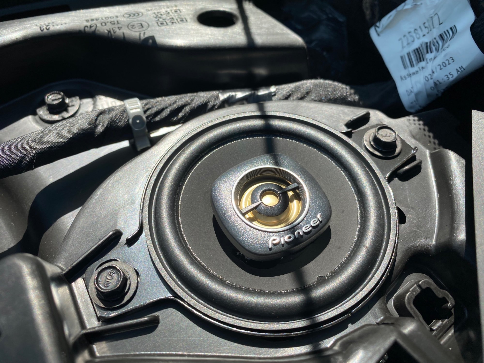

Mshawn Posted December 7, 2023 Share Posted December 7, 2023 On 12/4/2023 at 8:26 PM, traderfjp said: Anyone try Pioneer TS-A709 for dash speakers? They look interesting. I used tsa706 for the from dash they do great in my 2023 1 Quote Link to comment Share on other sites More sharing options...

Mshawn Posted December 8, 2023 Share Posted December 8, 2023 My apologies I did get the TS-A709 pioneers for dash speakers. They are 4 ohm. 1 Quote Link to comment Share on other sites More sharing options...
BigMick2023 Posted December 8, 2023 Share Posted December 8, 2023 13 hours ago, Mshawn said: My apologies I did get the TS-A709 pioneers for dash speakers. They are 4 ohm. Does the door chime and turn signals sound OK with the Pioneers? Heard others complain about it with aftermarket speakers. Quote Link to comment Share on other sites More sharing options...
Mshawn Posted December 8, 2023 Share Posted December 8, 2023 Yes if you do not use the inline crossover! Quote Link to comment Share on other sites More sharing options...

Mshawn Posted December 8, 2023 Share Posted December 8, 2023 On 12/7/2023 at 4:47 AM, Mshawn said: I used tsa706 for the from dash they do great in my 2023 My apologies these are pioneer tsa 709. Yes they are very good Quote Link to comment Share on other sites More sharing options...
