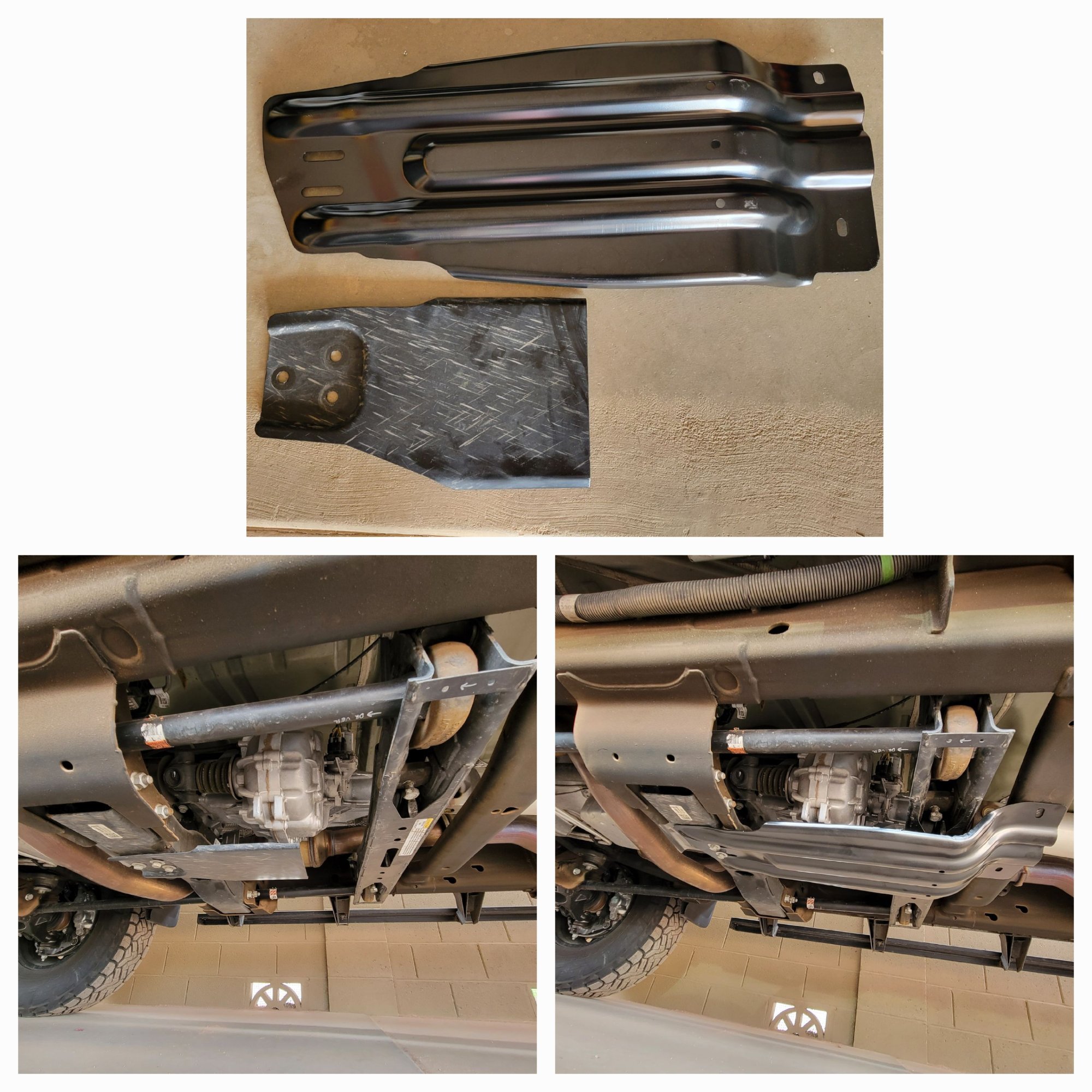

I spent $1,600 shipped for the full swap including skids and one-time-use TTY bolts/nuts. The only thing left to buy is a couple bolts for mounting the rear of the transfer case skid when I mock it up and decide if I can tap threads or use through bolts.
Figure ~$2,000 if doing it from stock to finished with a set of Bilstein 5100s.
X2
The ZR2 transfer case skid vs the baby Z71 skid. In the process of drilling the rear holes. Going to use through+bolts and nuts. Initially was going to tap M10x1.5 threads for one of the unused front Z71 bolts and add another, but didn't have the right 8.5mm or whatever PITA metric bit.
Fits on the 20-23 great, just need to drill rear holes.
