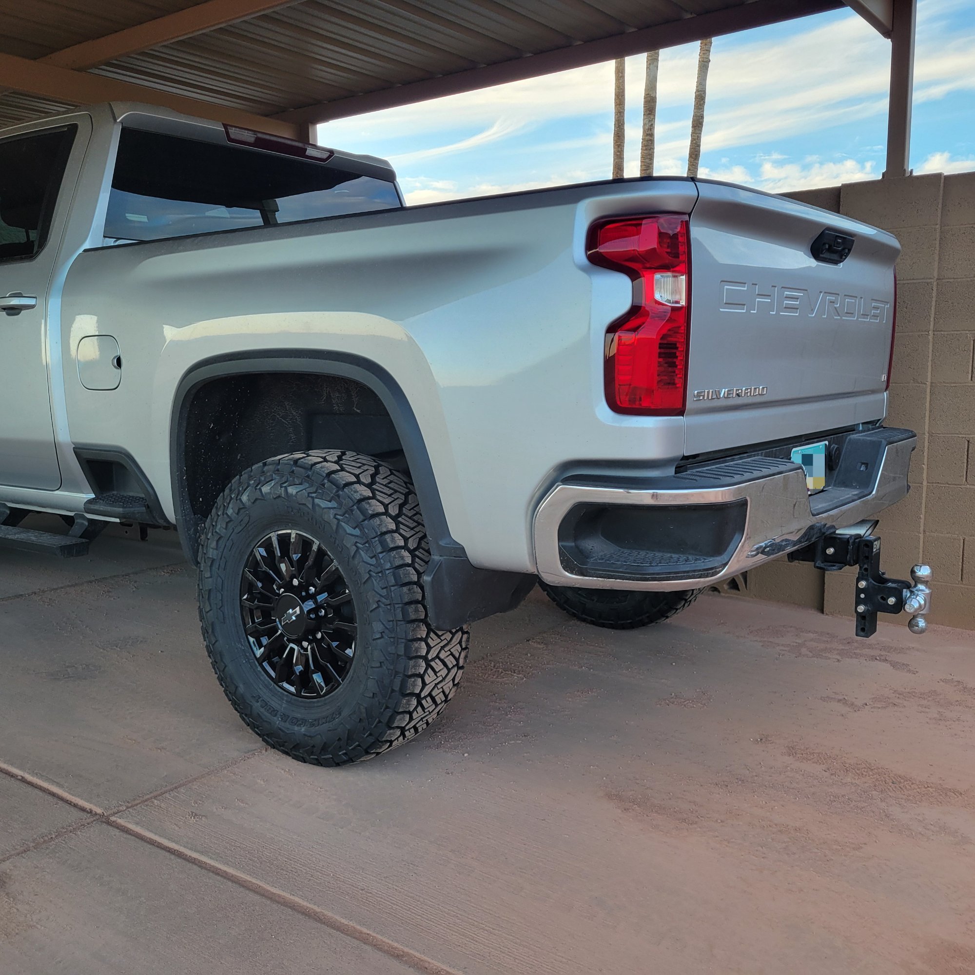

Front & rear ZR2 lift complete!
37x12.5s on GM 18x8s. No rub!20240406_132956.thumb.jpg.4bb8a7f0e806c06098ba3893c06248f8.jpg

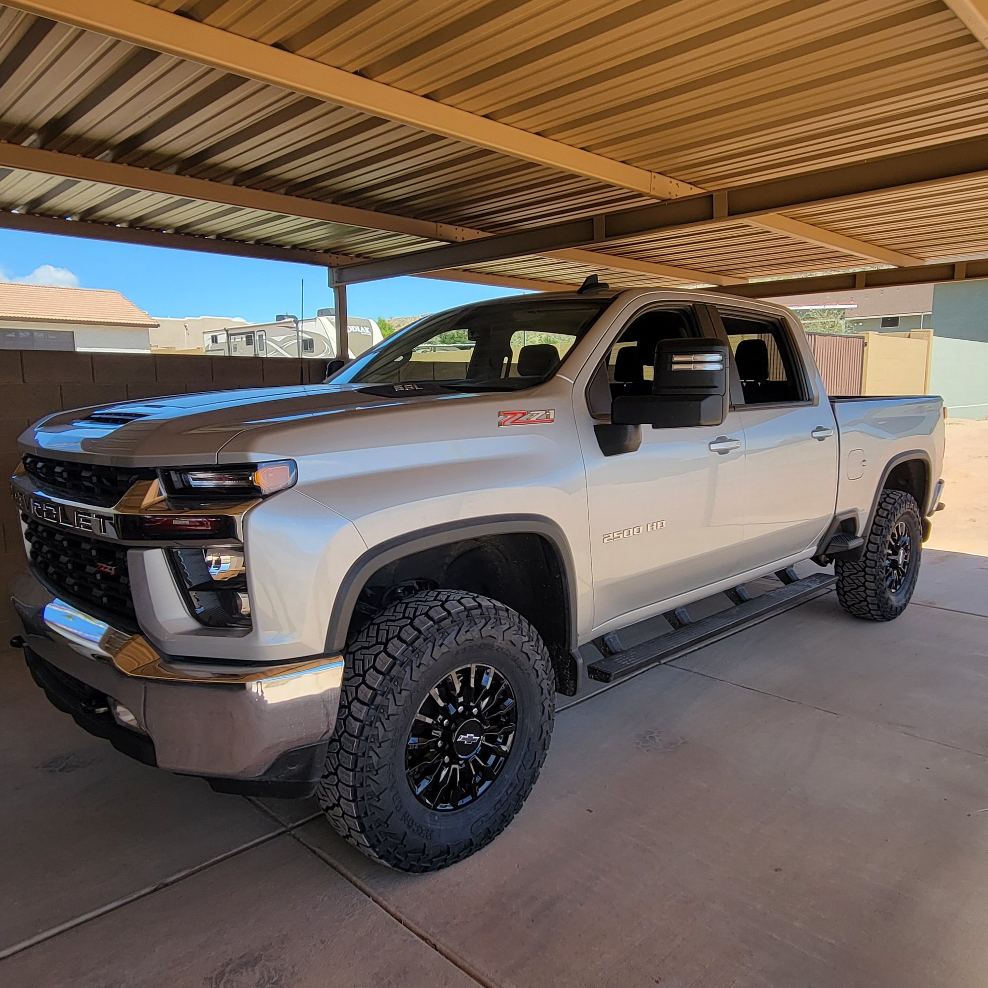

Complete minus alignment!20240401_155513.thumb.jpg.b081c10e7e0915fd5db0279cabb3c522.jpg

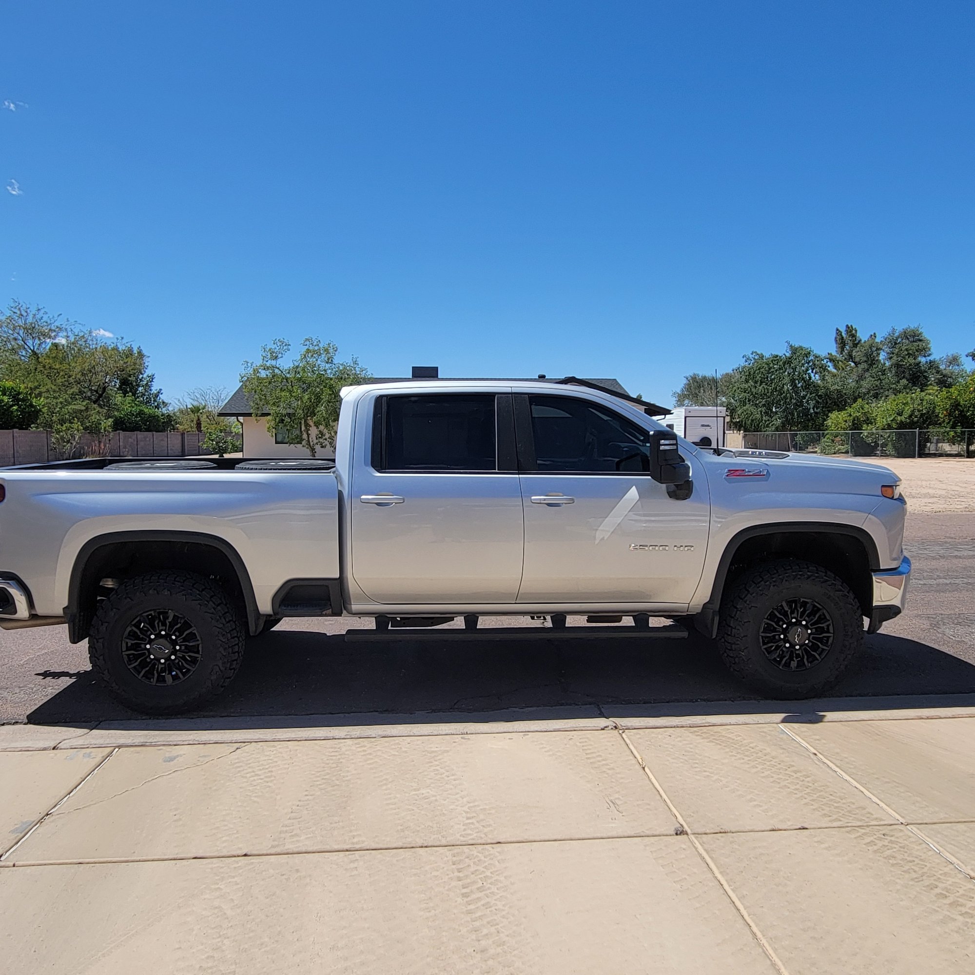

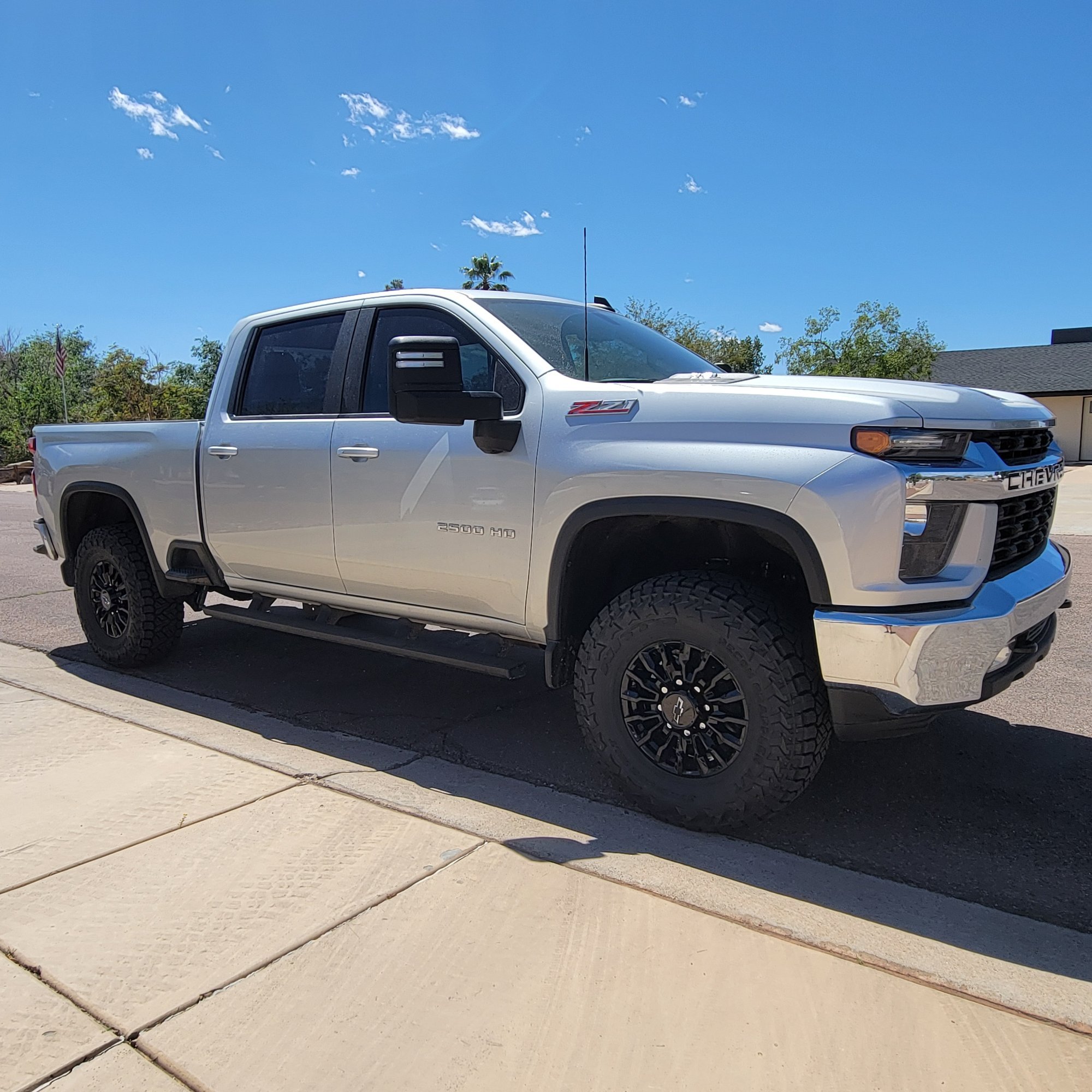

Ground to fender lip stock I was ~39.5 and with just the ZR2 lift on 265/75 (31s) I was about ~41 5/8 now I'm at ~44.5. My keys must be up a little compared to stock ZR2 because I'm even with the back and stock ZR2s are about 1.25 higher in the rear. My UCA ball joint angle is flat and perfect so with this lift I've achieved exactly what I sought out. A perfectly leveled look on 37s with no aftermarket wonk or adverse driving characteristics. In my opinion this set up is the best way to fill the wheel wells, the perfect lift height, and the best way to make it all last 200,000+ mi like stock.
For speedo I'm using the Pulsar LT. Running 50psi with lowered TPMS warning threshold, speedo corrected to the 37s, and throttle lag gone on level 3 response setting. It's like I have a brand new vehicle. Love it.
Edited by Epsilon Plus
Truck is pretty high now. At almost 6'2" I can stand against the back tailgate and my chin is only an inch higher than the top of the gate.
For the price of the parts and the drive as stock results, I really don't think there's a better way to get the 37s and proper look out of these trucks.
