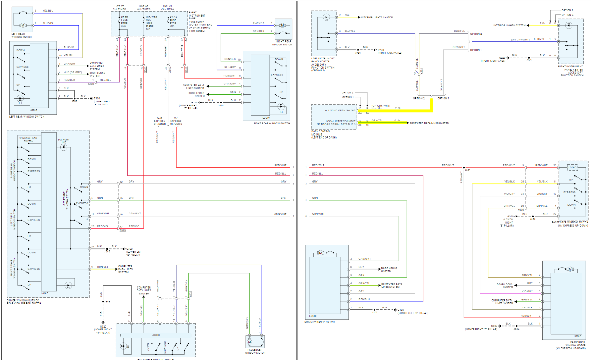

Overall Power Windows Schematic:

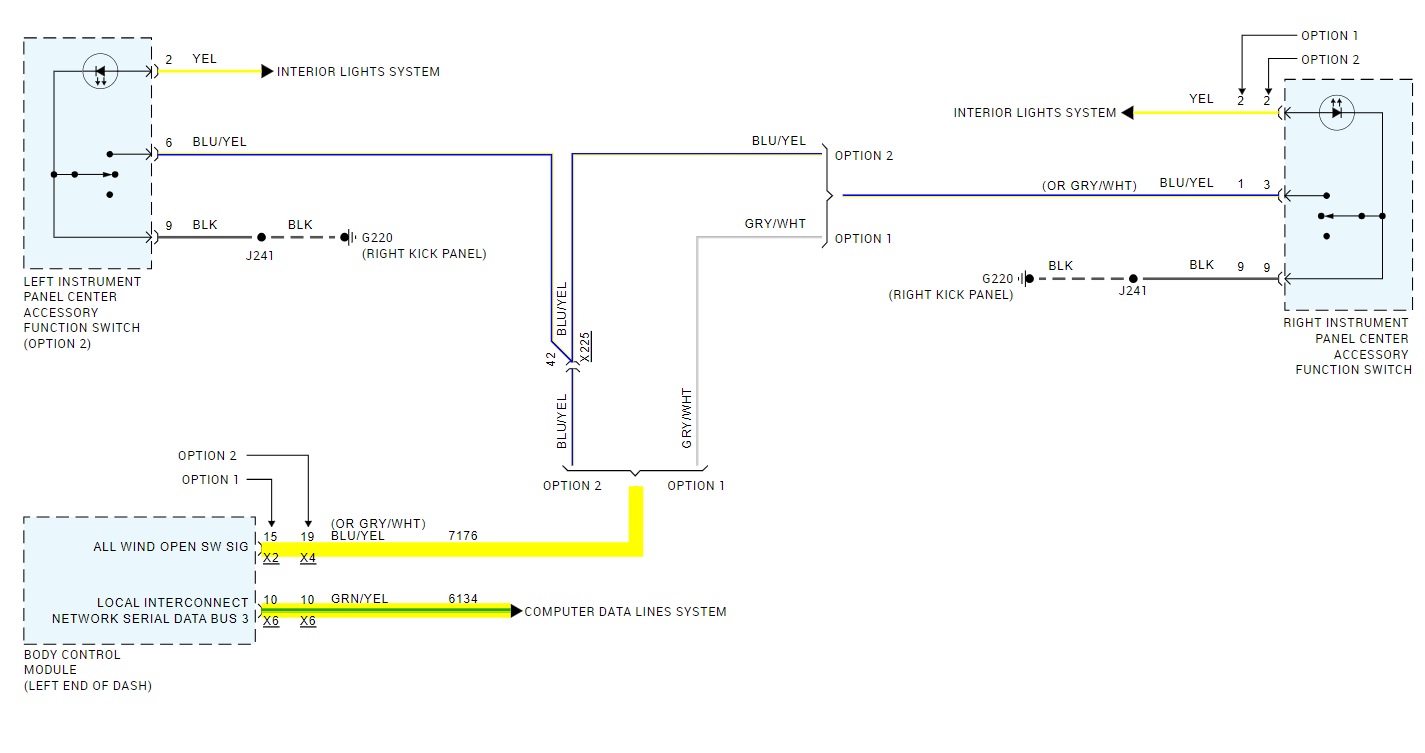

BCM and Accessory Switch Schematic:
