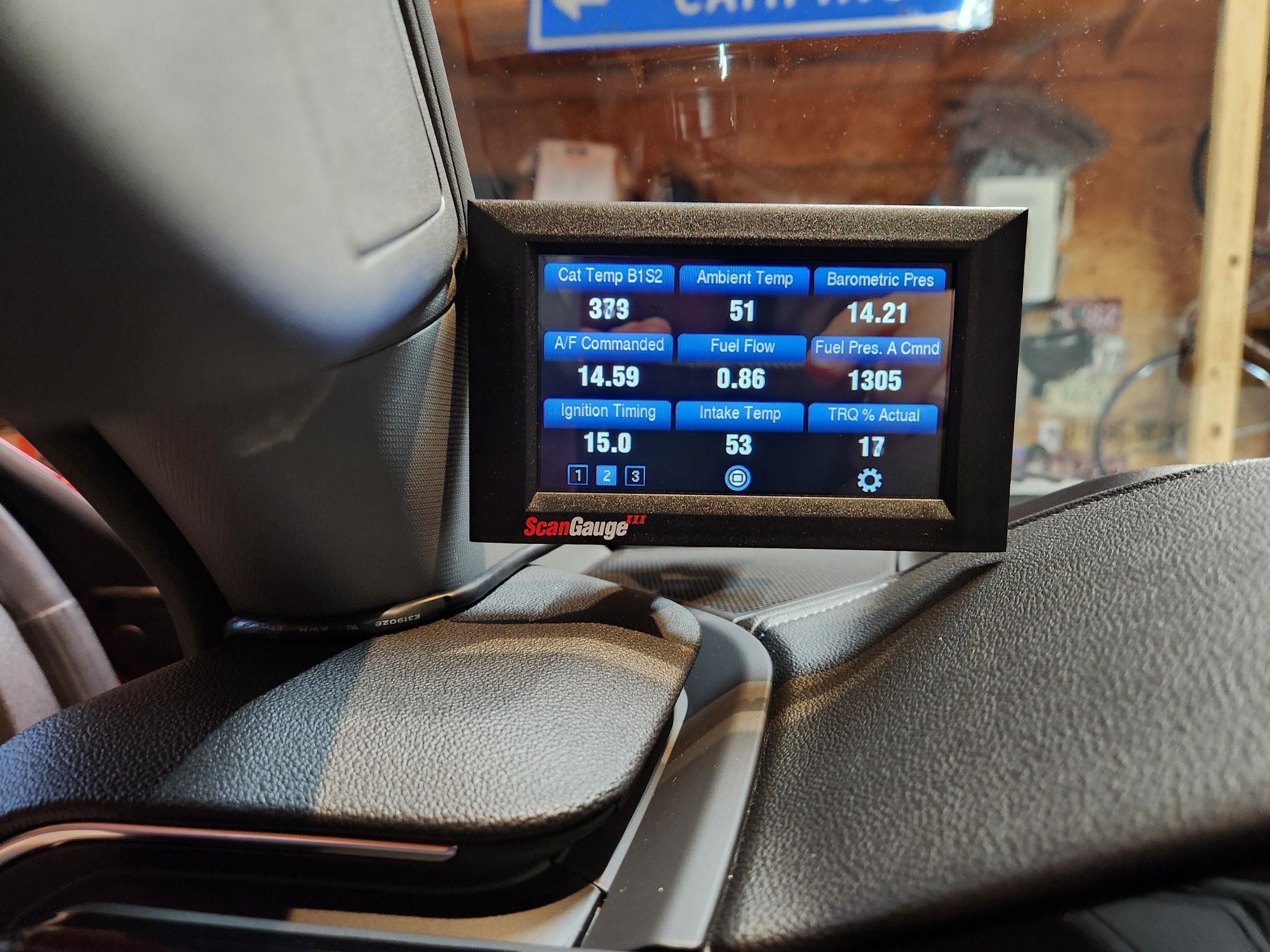

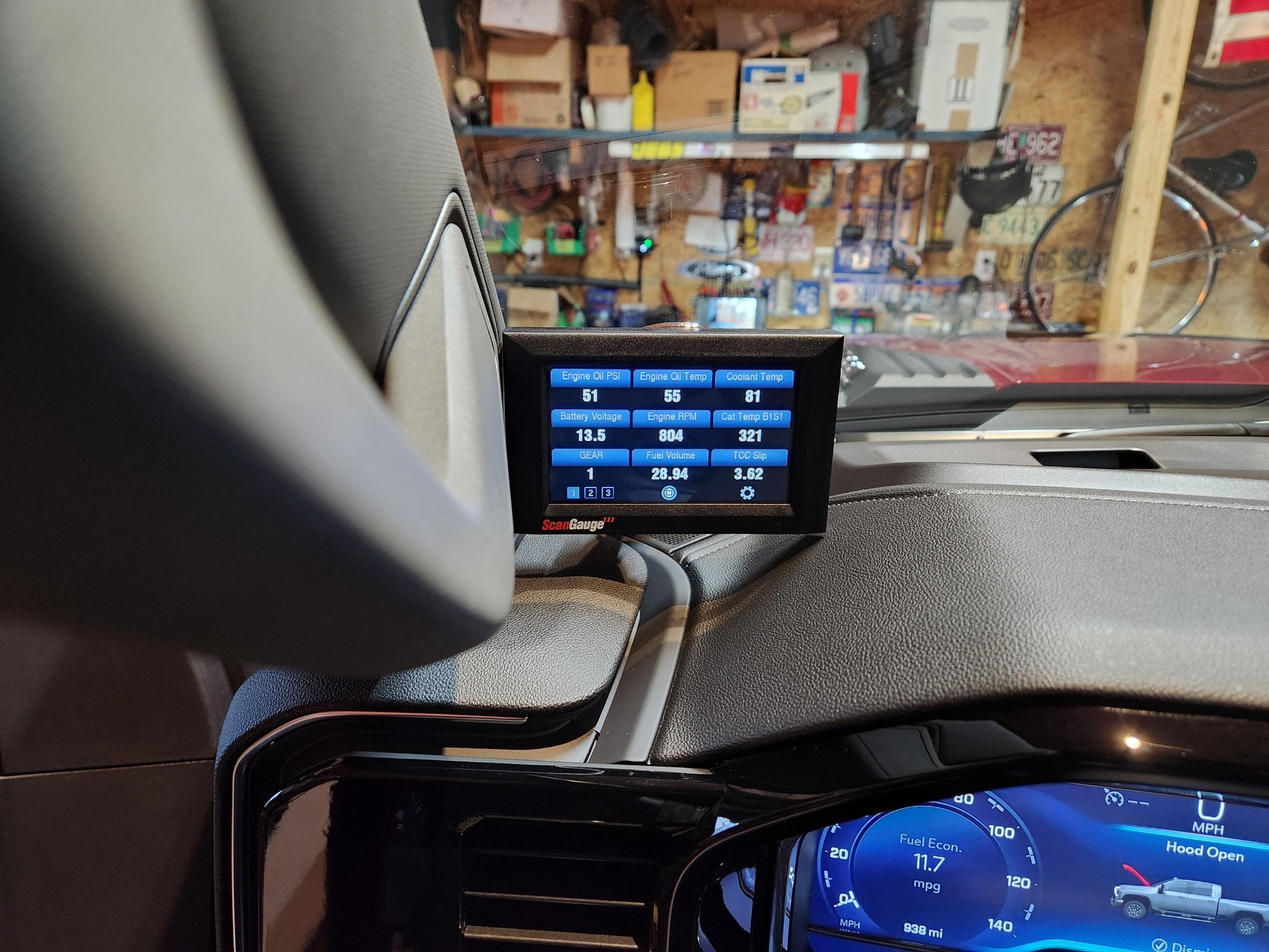

I am running the 2nd cat on the next page along with the engine load since I replaced that with the "gear" for the trans. Its always going to be a work in progress moving things around on the screens especially when I get my first pull in with the fifth wheel.
The display is actually as low as it will go. The angle I took the pic from is lower than my line of sight so it looks deceptively high. I will likely tweak that position a little.

ScanGauge replied to me again today, and are send out a Data Logger to me to run for 30 min. to track all PID signals, as all they asked me to try on X Scan, did NOT pull up the code to record the actual Gear in use.
Will let y'all know what I info get next. Suspect will take a week or so.

64BAwagon, Do you actually get an "In Gear" selected reading ?  My Duramax 10 speed does not. Only shows "Suggested Gear", that stays frozen as Neutral.  ScanGauge is sending me a data logger to map my '24 PID signals.

@Gregg Staples posted the codes and I put them in and created an X code file that I named "GEAR"
It shows "1" while idling and does not change when in Park, Reverse or Drive. I have yet to drive mine but he states that his is this way and the number will change as the truck is driven and shifts up through the gears.

Copy of the X-Code to type in to add "GEAR".  IT WORKS !!  '24 Duramax shows #2 gear in Park and Drive, as I learned Duramax does start off in #2, unless in Manual or 4x4 Low, then goes to #1. Shifts thru all 10, and down with engine ("Jake") brake on.
Gas 6.6 will show #1 gear.
Pic attached also, as SG-II or SG-III works with these X-Codes with a 6 speed trans as well.
Lots to type in. Fat fingers and small letters, easy to get a typo, as 64BAwagon said. If it dosent work first try, re-type it in till it works.
ScanGauge still sent me out a data logger, to run and return to them. Will still do this as they may find more codes we may have available.
