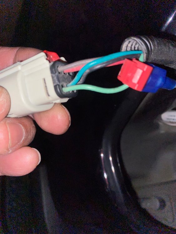

13 hours ago, typhoon186 said:
From a previous post:  Its the light green wire..  Will try tomorrow and see
You might get away with that line tap in SC but that definitely wont last up here in the rust belt. I typically cut the wire and use a heat shrink butt splice to make the connection and then use a second heat shrink sleeve over that. The salt eats these things alive.
On these trucks the only thing that works on the trailer plug is the 12V+ and ground unless a trailer is plugged in. That's the reason for tapping in at the light wiring itself.
