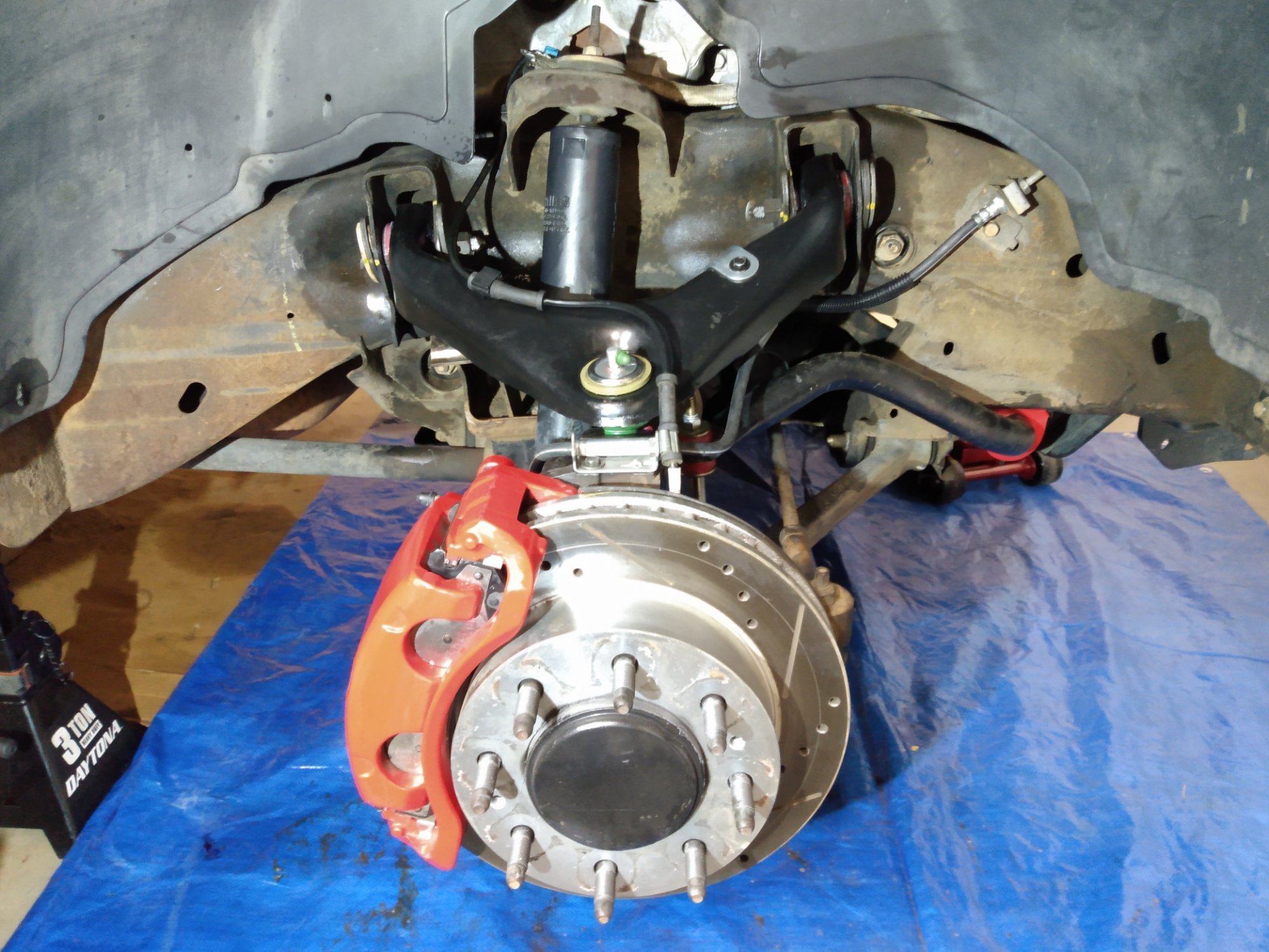

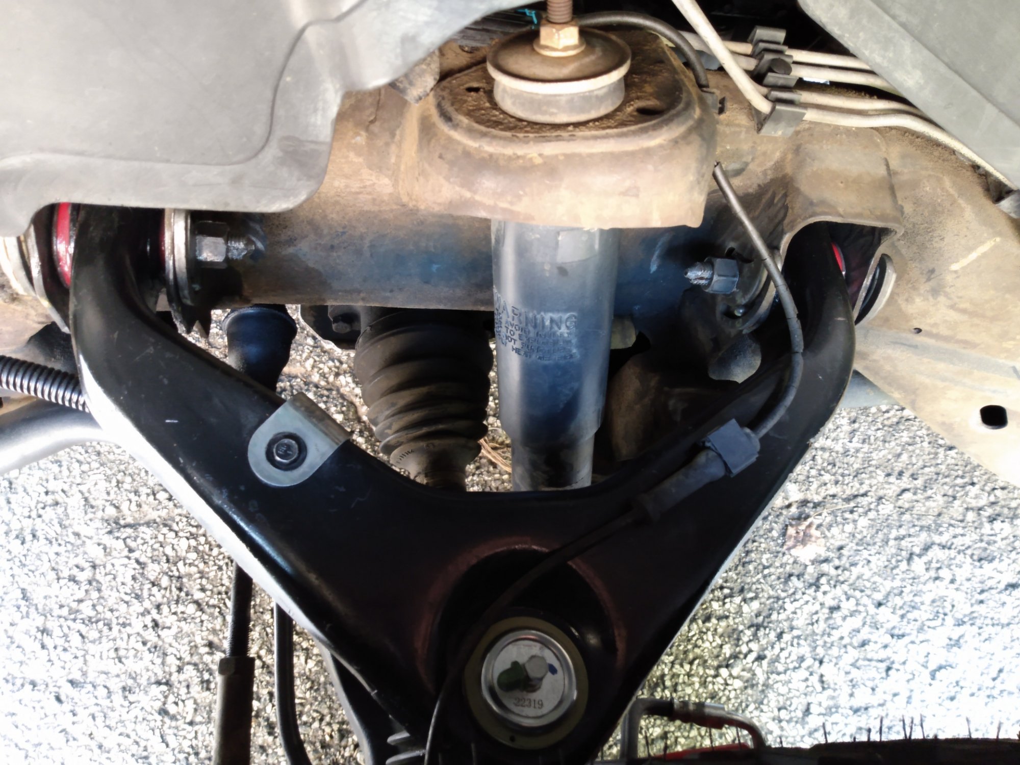

Last week I finished the Upper Control Arm Bushings and the Upper Ball Joints.
Next, I have the Lower Control Arm Bushings and Lower Ball Joint to do. I need a 35mm Socket for those. That is on order and I am waiting on it to arrive.

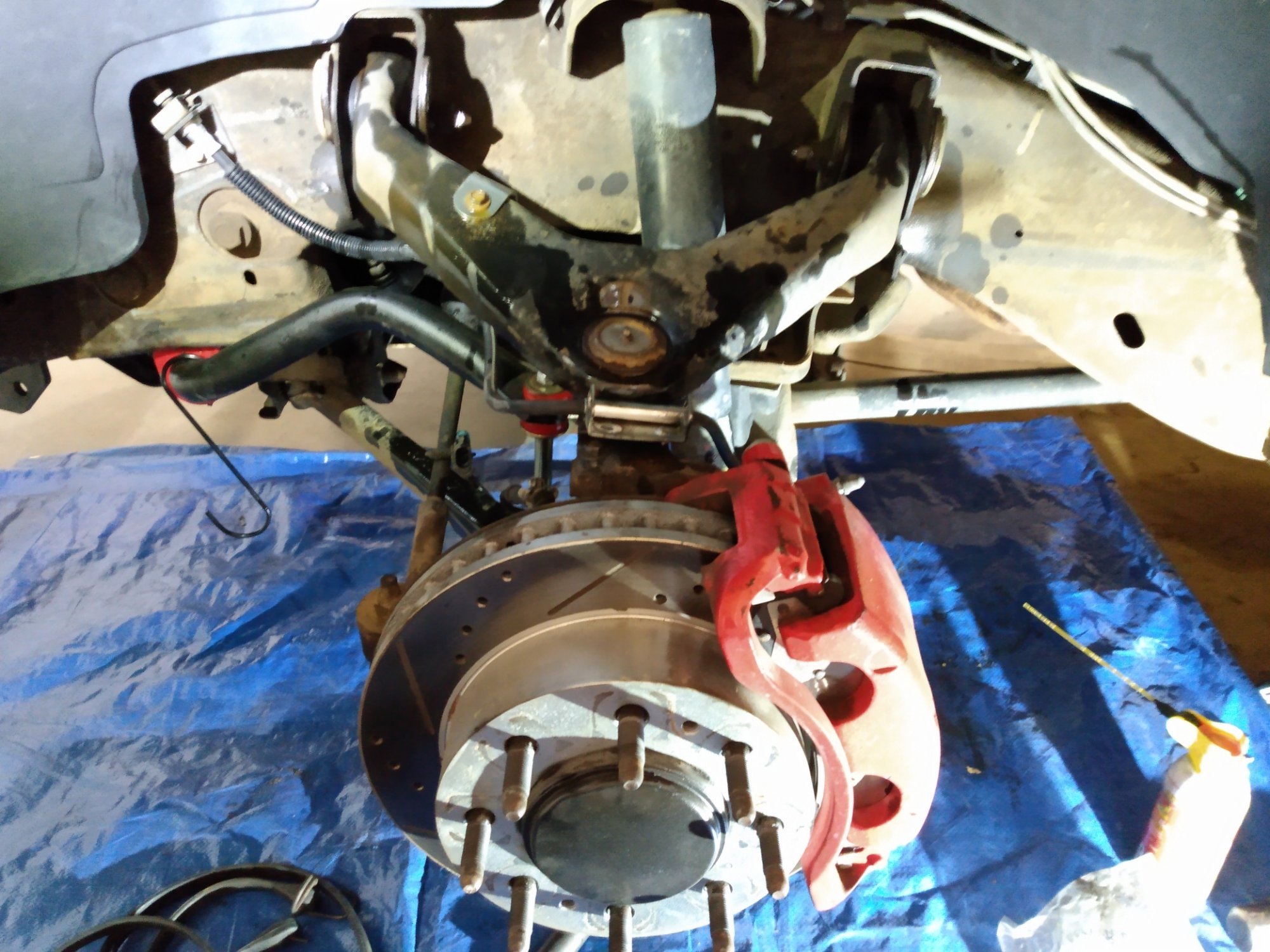

I was hoping to finish the last of the bushings last week while I was on vacation. No luck, the 35mm socket that was supposed to show up Thursday before last did not show up until this Saturday. Needless to say, that I did not get started until Sunday, yesterday. I am starting with the Passenger side and having no luck at all getting the Wheel Hub Nut off. Is this a reverse thread?
